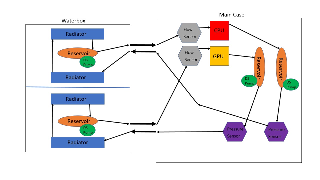

I kind of understood what I should have done instead of current useless layout but Im more confused now in terms of what is the best way to move forward, I have attached a photo showing an overview of what my dual loop layout looks like including external waterbox setup and pressure/flow sensors connections between reservoirs, It might also worth mentioning that im planning to add 2 leakshield devices on top of both reservoirs in the main case in near future, with all that in mind I got the following questions:
Is it still worth it to keep the pressure sensors in the loop even after adding leakshields?
If yes, where would be the best place to locate them to get the most use out of them?
How can I connect them in a perfect sturdy hardline loop without leaving loose ends for the push-in soft tube fittings? can I use T or Y fittings?
Kind of unrelated or maybe on a side note about the leakshield, is it suitable for my current setup or no?
Note: I forgot to mention that the 2 pumps in the main case are D5 Next pumps
Your diagram appears to have coolant flowing through the MPS Pressure Sensor... this does NOT happen. There is no flow through the sensor.
Here is a simple diagram showing how a pressure sensor may be installed {sensor_install.pdf}
I have not built a loop with dual reservoirs. Hopefully someone with experience will jump in and discuss that, particularly in respect to adding LeakShields.
I am also not versed on the impact of a LeakShield on a Pressure sensor.
