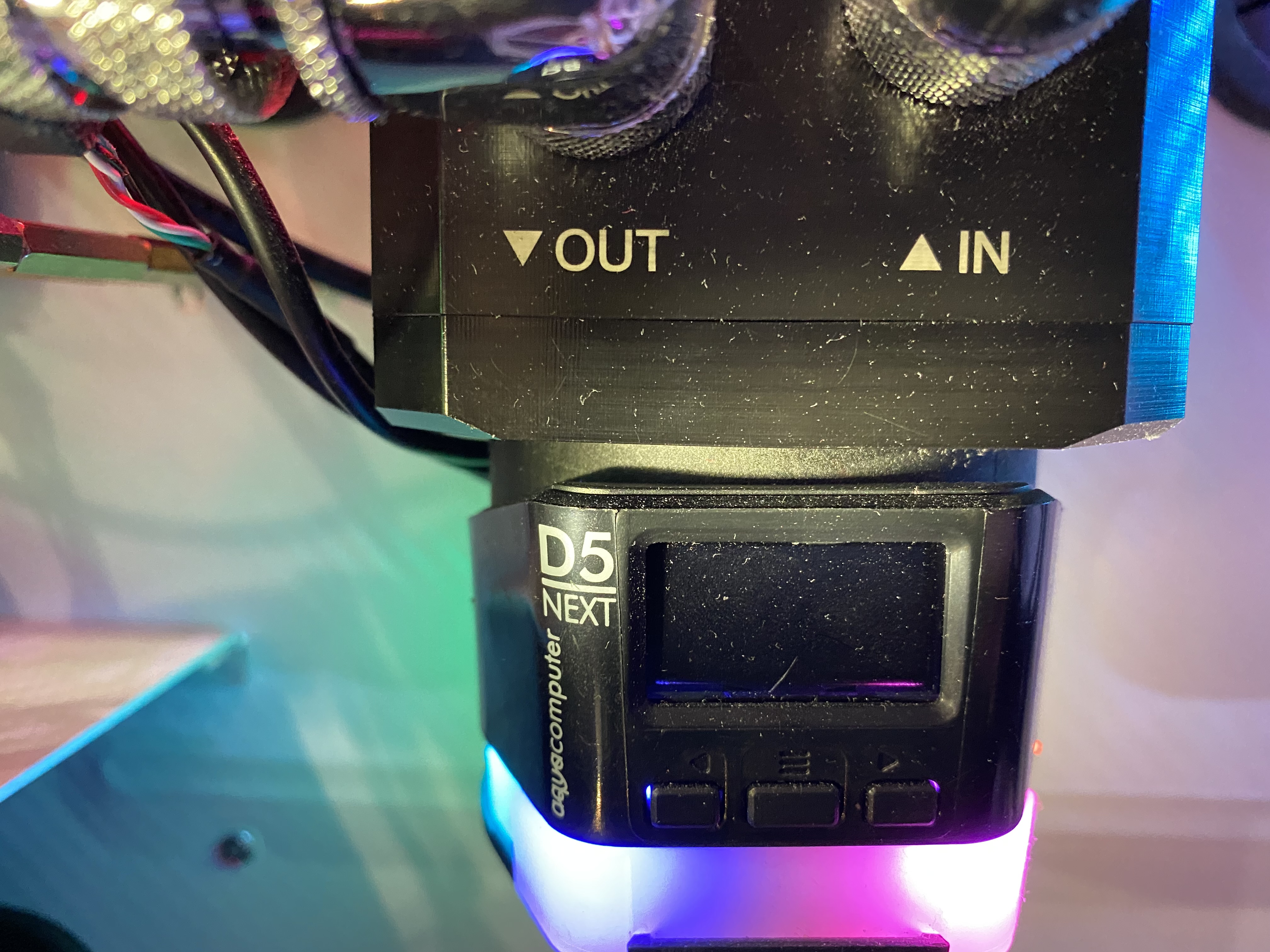

Hello,
i need an info about the product in subject.
Can i dismantle the pieces for use the d5 pump with another tank compatibile with others d5 pumps?
Also, can i use the leakshield with another tank?
Thank you.
Donnerstag, 20. Januar 2022, 08:21
With restrictions, yes.
The D5 NEXT is a simple D5 pump with additional control electronics, it also fits other reservoirs or pump tops, you just have to make sure that the mounting ring is not too thick, otherwise you can no longer put the electronics on the pump.
The LEAKSHIELD can also be used in pretty much any combination, for this there are different mounting kits.
If it is to be combined with a reservoir from another manufacturer, you still need this stand alone set .
