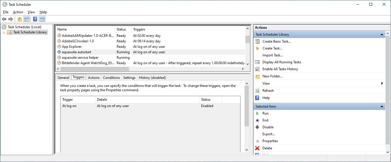

Have you checked the Task Scheduler for anything unusual? {task_scheduler.jpg}

Donnerstag, 27. Januar 2022, 03:59
I did get it to work. Had to go into Task Scheduler. Edit the "aquasuite autostart" task and check the "Run with highest privileges" under the "General" tab. :)
z00mantwo
Sonntag, 6. Februar 2022, 04:16
Issue came back randomly. Had to go back in to the Task Scheduler again and make the change. Something turned off the "Run with highest privileges" under the "General" tab.
