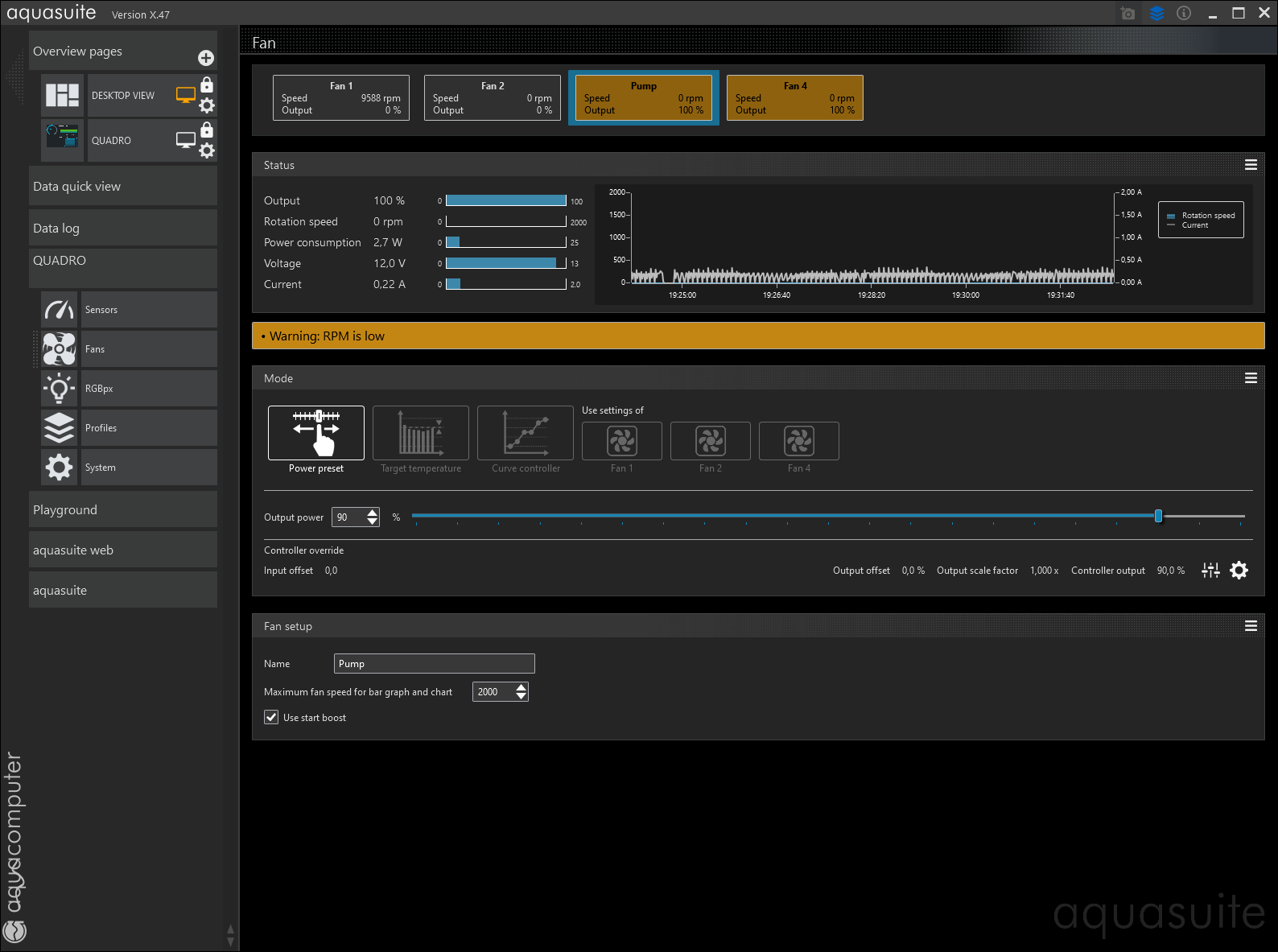

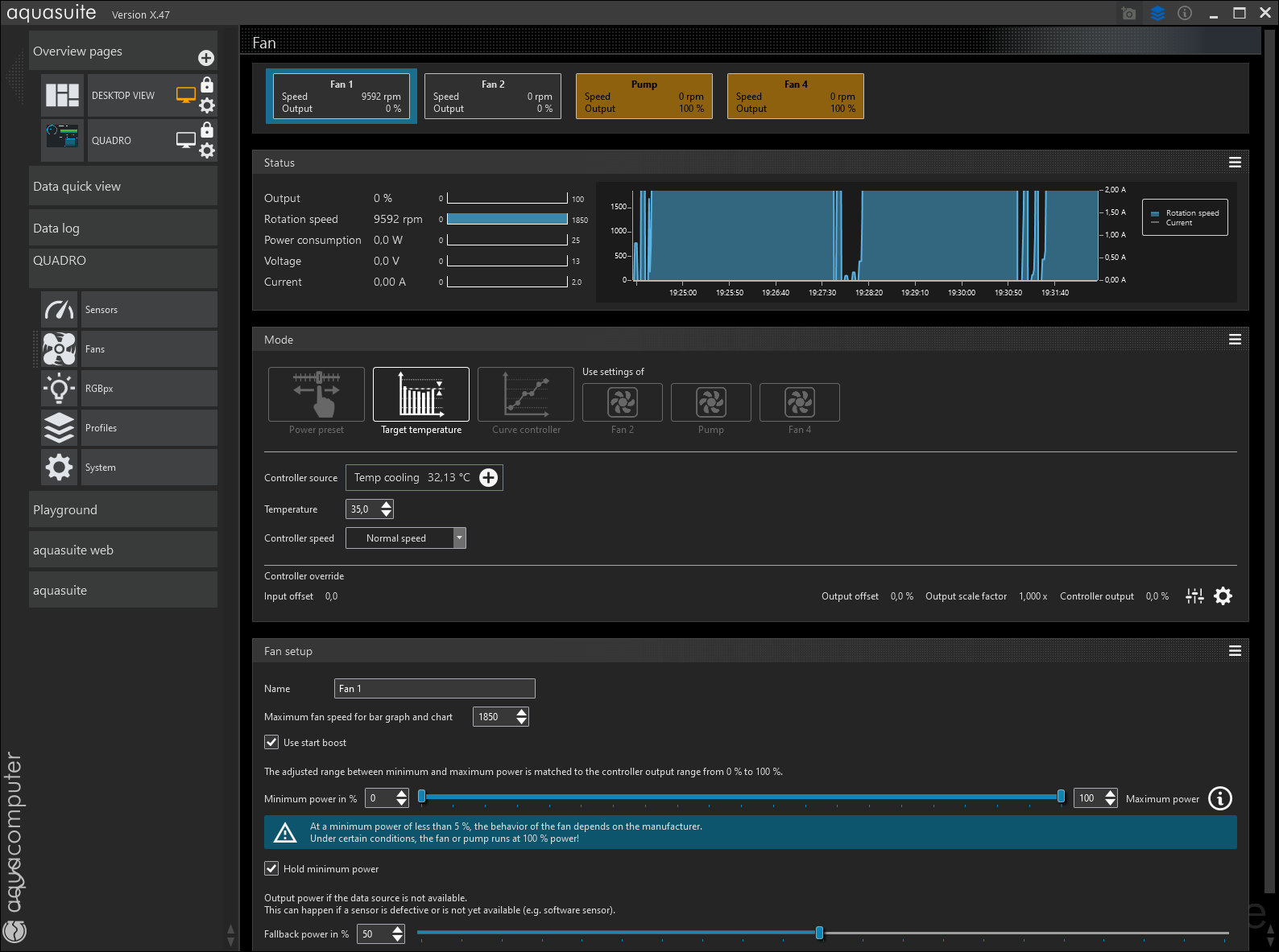

I m looking for help with my quadro because I just switch all my pc into a new case and when I plug in, I have Fan 1 running full speed no matter what I do even trying to put 0% and I have on Fan 3 is my pump and I know is running but I have no RPM showing.
Some screenshot of the issues if someone had the same issues because I can t understand it was working fine in the previous build...

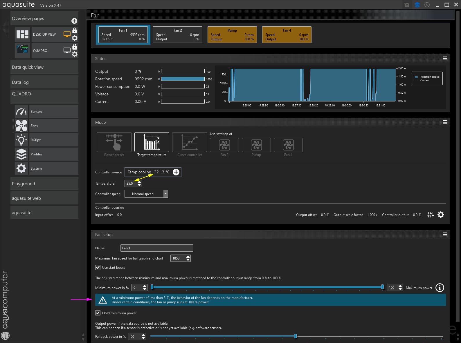

Your fan 1:
  • your controller source is below your set temperature, so your controller output is zero
  • your fan setup has minimum power at zero %
  • depending on your fan make, you may be experiencing the issue outlined in the blue box below the setting bar {fan-1.jpg}
The pump is a little strange:
  • your controller is set at 90% ouput, but the status shows 100% output
  • you have a 0.22 amp current draw
  • there should only be a current draw if are drawing power from the fan controller port
  • if you are drawing power from the fan controller port, you may want to check the pinout on the fan connector you modified
