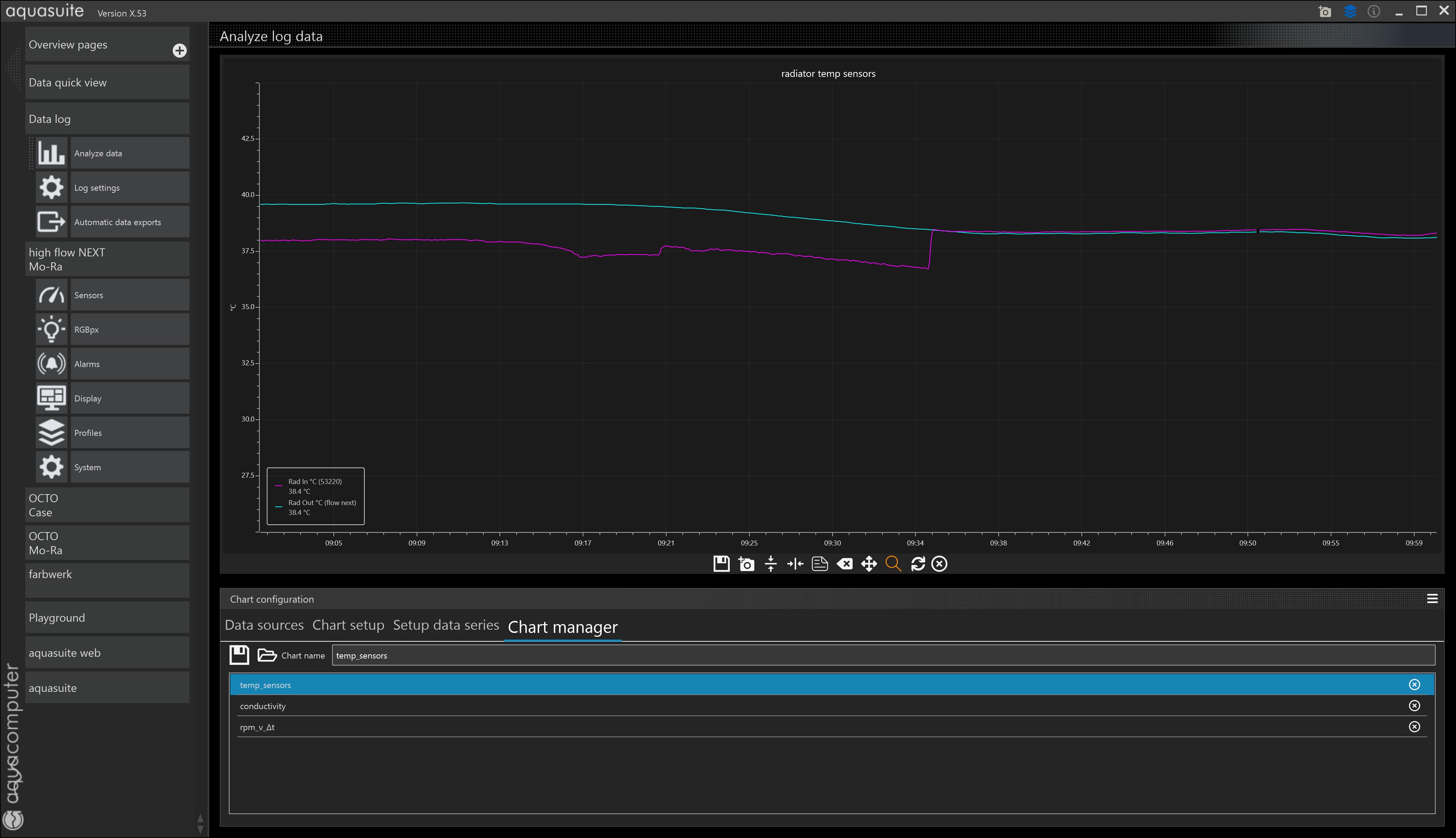

Recently one my temperature sensors started having an issue.
I have a flow next after the radiator and a temperature sensor at the radiator inlet connected to the flow next external port.

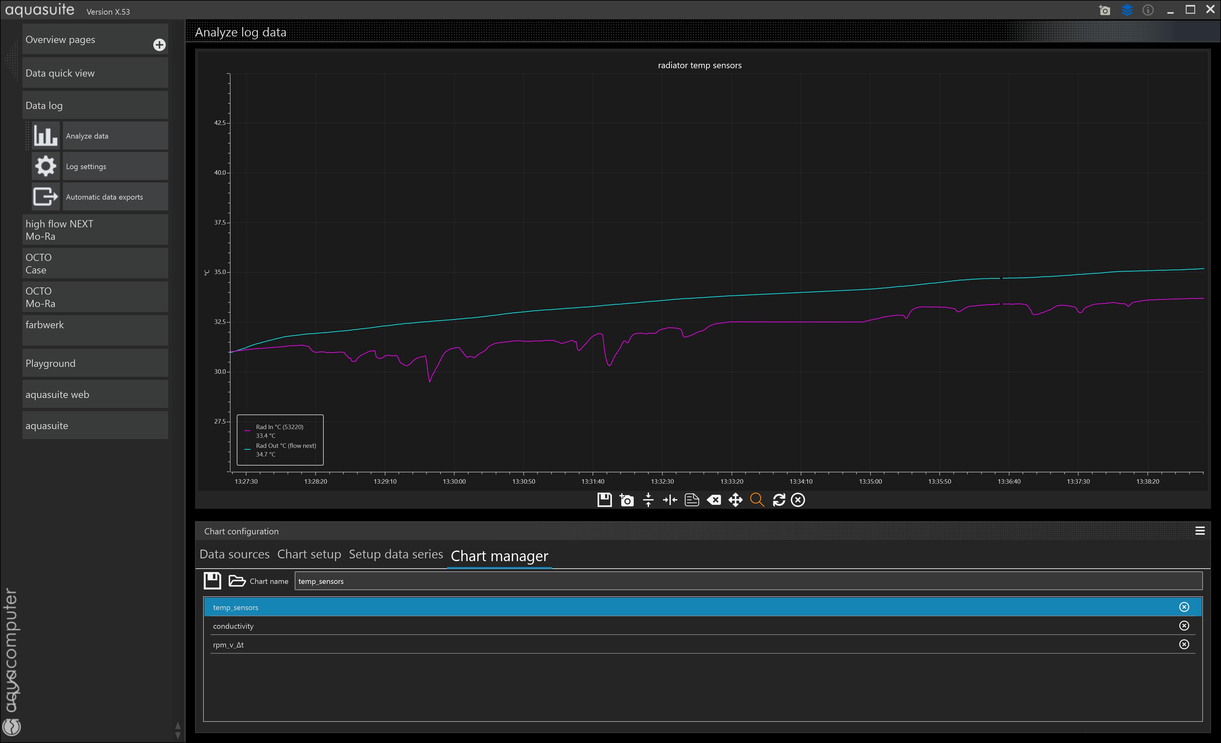

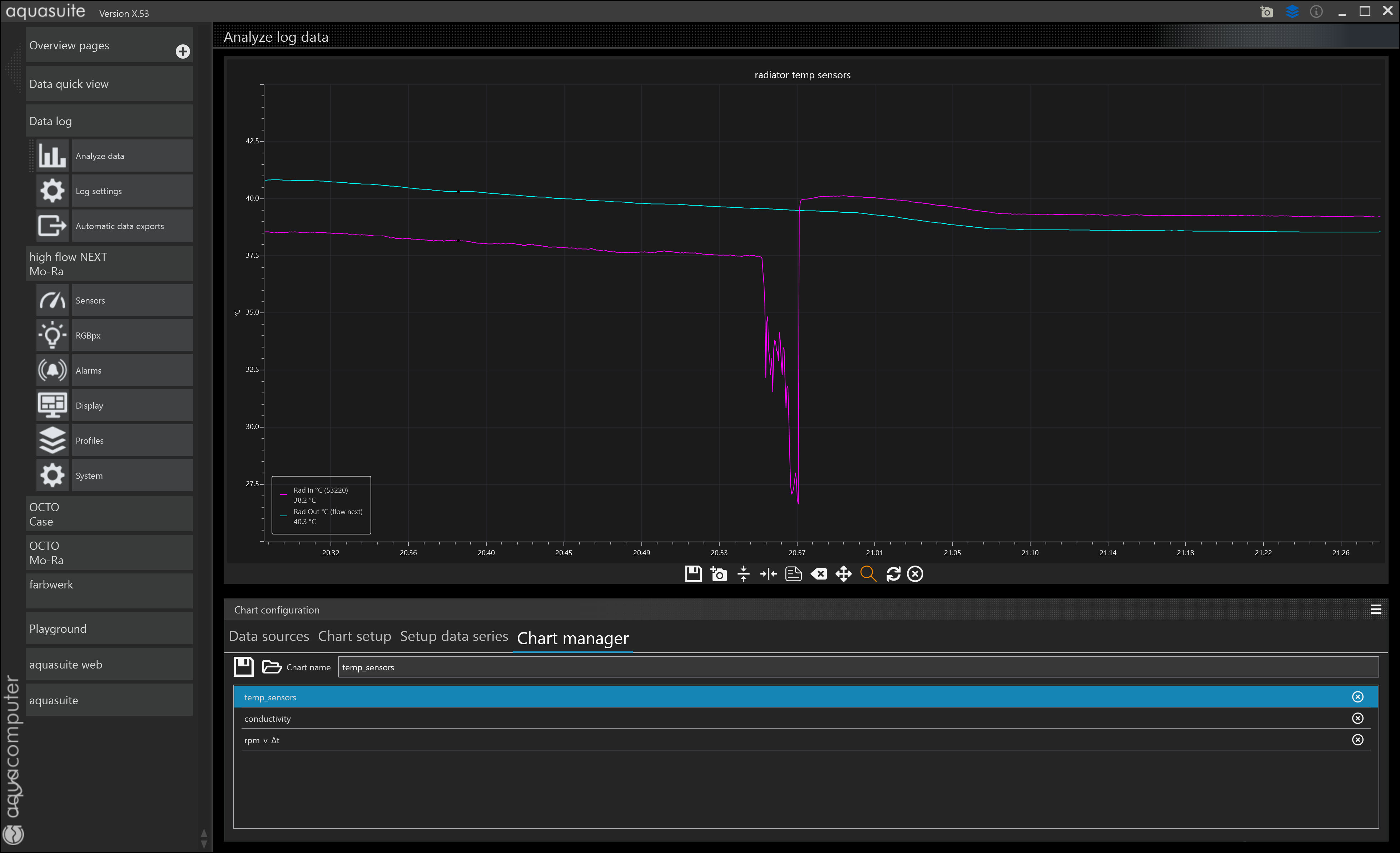

A couple days ago the inlet temperature was reading cooler than the exit temperature.What is happening here?
Is this a continuity issue?
Remayz
Freitag, 6. Mai 2022, 09:59
looks like it.
resistance decreases with temp rise on NTC thermistors. those dips of temp could show an intermittent contact inside, so do the noise.
could be a bad contact with the controller too, maybe try to clean the contact pins, or just unplug/.plug several times to rub the contacts, see if it changes anything (with power off)
