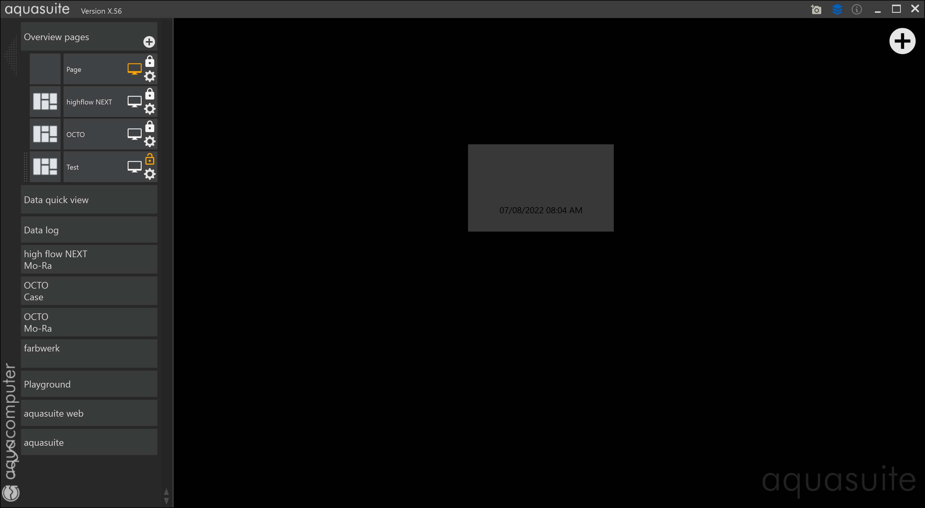

I believe showing the time in a formatted manner is doable using the XAML function.I am not XAML literate, so I do not have any hints as to how.
The gauge needle movement may have a hysteresis built in to keep it from bouncing around, and/or being graphical it may have low update priority.
EDIT: I edited the Binding option of the XAML function to display the date and time, which you may be able to edit to suit you. (time.jpg)
EDIT2: The display does not appear to update, so more code is needed. As I said I am not literate in XAML programming.
<UserControl
x:Name="this"
xmlns="http://schemas.microsoft.com/winfx/2006/xaml/presentation"
xmlns:x="http://schemas.microsoft.com/winfx/2006/xaml"
xmlns:mc="http://schemas.openxmlformats.org/markup-compatibility/2006"
xmlns:d="http://schemas.microsoft.com/expression/blend/2008"
xmlns:sys="clr-namespace:System;assembly=mscorlib"
mc:Ignorable="d" d:DesignHeight="300" d:DesignWidth="300">
<Grid>
<Grid.RowDefinitions>
<RowDefinition/>
<RowDefinition/>
</Grid.RowDefinitions>
<!--Simpe databinding example-->
<!--1. set up connection for this item (ie. temperature sensor)-->
<!--2. bind values to your own usercontrol-->
<!--Binding example-->
<!--Content="{Binding ElementName=this, Path=DataContext.Value, FallbackValue=no data available}"-->
<!--default background-->
<Rectangle Grid.Row="0" Grid.RowSpan="2" Style="{StaticResource GadgetBackgroundStyle}"/>
<!--Content: binding to source value: -->
<!--Content: ElementName=this -->
<!--Content: Path=DataContext.Value, for connetion to actual connected value -->
<TextBlock
Text="{Binding Source={x:Static sys:DateTime.Now}, StringFormat='dd/MM/yyyy hh:mm tt'}"
Grid.Row="1"
Opacity="1.0"
Height="Auto"
Width="Auto"
Foreground="#FF000000"
FontSize="15"
FontFamily="Segoe UI"
FontWeight="Normal"
Margin="0,0,0,0"
HorizontalAlignment="Center"
VerticalAlignment="Center" />
</Grid>
</UserControl>

In the next aquasuite version it is possible to use date and time in the code/XAML controls. The time will then update automatically.
Quellcode
1
<TextBlock Text="{Binding Path=TimeNow, StringFormat='dddd, dd MMMM yyyy HH:mm:ss'}" Foreground="White"/>

Mittwoch, 10. August 2022, 07:26
I assume by next version you mean X.58
the current version is 57, the next 58.
currently the binding with time work only once. the time dosent refresh. We have added also a few samples in the xaml presets how to use the time.
