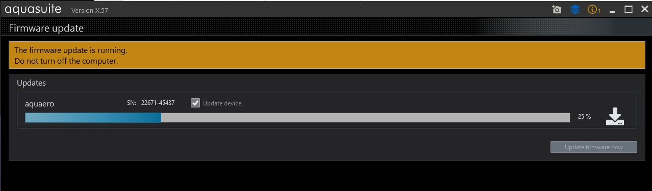

Aquaero firmware update gets stuck at 25%
Sonntag, 14. August 2022, 16:29
The issue : under Aquasuite X.57, I managed to update all my components firmware, except for the Aquaero 6.
All devices are plugged by USB. The Aquaero seems to work (it's an old Aquaero, it worked with its old config. I tried a factory reset and now of course all the fans are at 100%)
The AQ6 is plugged to a Hubby 7 along with 2 Ultitube Next, 2 Flow Next, 1 Cryos Kuplex vision. All the other devices seem to work and got updated with no issues.
I also have an Aquabus with the same devices, plugged via a Splitty9.
Apart from the AQ6, all devices / cables are brand new
I tried :
  • to reboot
  • cut the power for 1min
  • to factory reset the AQ6,
  • to plug the AQ6 directly to the motherboard and remove all other Aquacomputer USB devices
  • to unplug the Aquabus
nothing worked.
Any idea what to try ?

Sonntag, 14. August 2022, 16:34
Try to connect the Aquaero directly to the motherboard and disconnect the other internal USB connectors.
Jubijub
Sonntag, 14. August 2022, 16:38
Edited, I just tried that, same issue
Jubijub
Sonntag, 14. August 2022, 19:50
I fixed it with a hard reset (with the jumpers) to put it in recovery mode.
