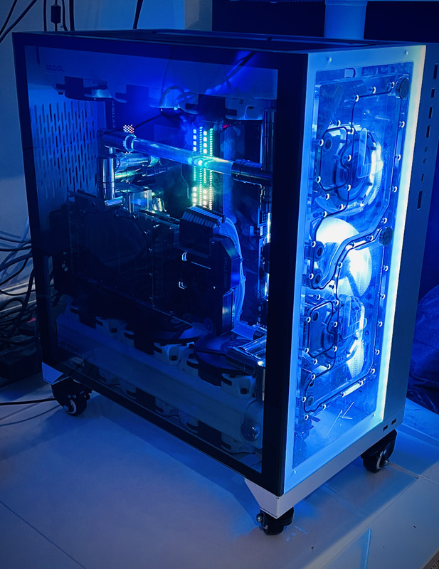

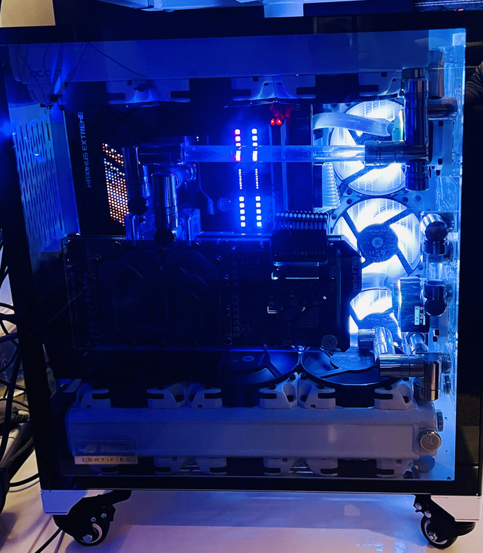

Hi yes I have a ‘relatively’ restrictive loop: 1x360 65mm, 1x360 45mm, 1x360 30mm, cpu block, front and back gpu blocks, a vertical reservoir plate, and lots of 90 degree fittings. There are setups a lot more restrictive than mine I guess and no doubt people will happily run those off a single pump.
But I wanted to keep pressure up and pumps at lower speed. I have no prior experience to back up this decision and it was based on researching the topic on the internet prior to designing and building my system. If you read articles like this (there are lots of others) it gives a good explanation: https://martinsliquidlab.wordpress.com/2…es-vs-parallel/
However now I am running it, aside from the dual pump at same frequency issue, I am experimenting with the characteristics of it. I have not yet been able to calibrate the flow meters on the pump, hope to do that soon, but should have put an actual flow meter in my loop from the off

hehe it's like a wartime stock of 90° fittings :p I have no doubt if you start bending tubes to replace them you'll definitely be able to drop a pump :)
The components themselves don't look that restrictive, but all those 90s will definitely limit the max flow.
Not long ago i removed a 3x90° run on my pump intake to replace with a 2x45° and gained 20L/h, just with that. kind of gives an idea :)
Still, a single pump is definitely enough imo
(and if you want to keep the speed low, there's still the DDC option. They vibrate less than D5, have slightly less max RPM but higher head pressure at the same speeds.. so you can run them slower for the same flow, maybe worth a shot in the future if you feel the need to experiment)

Haha thanks Remayz feeling like such a noob now :) I went for 90s for a clean run obviously, I was building wondering exactly that: ‘how much more restriction is this adding’ but then had read that it’s not such an issue if there’s decent flow. ‘Water is water’ was a thing I’d read quite frequently. But knowing I was going to go to two pumps on the basis I had quite a few components I was guessing 90s would be a non issue.
Ultimately this line of enquiry - hence the original post which you guys did such a great job on answering - is about seeing how silent I can go, and the loudest elements at ‘work from home / idle / non-gaming’ situations are the pumps, by a country mile. Hence wanting to control the dual frequency, and, to start to profile them to activate as load requires.

Looks like a nice clean loop!
Some unsolicited thoughts here:
  • Remayz is correct that the 90s are probably your primary restriction, especially as flow rate goes up. He's also correct that they look good :)
  • Flow restriction might not be a problem in your loop. You can some basic sense of this by:
    • Get some good steady-state load into the system. Honestly, mining is as good as you can get for doing that.
    • Set fans and pump to full speed
    • Monitor the coolant temp and wait for it to hit a mostly steady temp
    • Reduce pump speed to 90/80/70%
    • At each stage, see what happens with coolant temp and also GPU component temp. You don't need to know the actual flow rate for this, just the coolant temp and pump speed.
    • See how low you can go with the pump before the coolant temp at the pump inlet or GPU component temp rises to an unacceptable level
  • Based on that test, you may find that your loop needs less flow than you thought. This is pretty well aligned with what was noted in the big ExtremeRigs testing which found that going from 0.5gpm to 1.0gpm in most rads gave less than a 10% increase in dissipated heat, and going from 1.0 to 1.5 made an even smaller increase. The one exception is for very thick radiators (especially thick + xflow) where going from 0.5 to 1.0 made a meaningful but not big difference and 1.0 to 1.5 made a small one.
  • You're probably going to find that, from a flow perspective, you're good with just one pump. That said, having two means that you can lower speed on both and that will ultimately make them last longer. Then again, two pumps means twice the probability that one will fail.
  • Resonance will be impacted by the pump mounting, pump orientation, and the stiffness of the mounting surface. Individual pumps mounted to different components using noise isolating mounts will be the quietest option with potentially zero resonance. Coaxial pumps mounted to a large vertical surface with solid standoffs is probably the loudest possible option.
  • If you run a Leakshield, you may need to keep dual pumps turned down pretty low to avoid exceeding the maximum pump pressure it can handle.
  • Honestly, I've never found properly mounted D5s to be loud. I have a quad rad 1000D build with two D5 NEXTs which actually goes fanless at idle and I can't hear the pumps when that happens.

The flow reduction test will show the GPU temp rise drastically once the flow is just too low.
You seem to have the same waterblock sandwitch i have, so i guess it will happen around the same flow ~70L/h, which is pretty low. On my rig, it happens somewhere under 40% PWM, yours probably a bit faster..
D5 have noisy regions depending on the model and mounting. Mine was heard mostly around 55%, 66% and anything above 75% (both on tube reservoir, and mounted on an EK FLT pump/res). Maybe you'll find the NEXT have that kind of behavior too. The trick is making a fan curve that avoids those noisy spots, and still provides enough water to cool the blocks. Sometimes you have to speed up to make it more silent which is counterintuitive too.
Bottomline, any flow at or above 100L/h is enough for a single GPU + CPU.
With your thick radiators, I wouldn't worry much, even with that lot of fittings :) Of course they restrict the flow, but i am fairly certain even with one pump you'd still manage.
