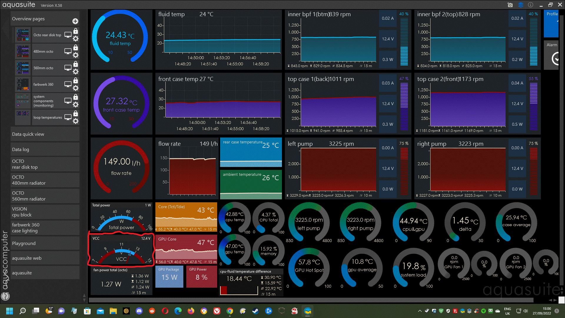

Seems like a high VCC Voltage in aquasuite
Dienstag, 27. September 2022, 16:07
Just noticed since updating to X.58 aquasuite that my VCC Voltage goes from like 12.1-12.5V almost instantaniously,should this be something that i should be concerned about,im not saying that aquasuite is the issue here,what i am saying is it an underlying problem that i could have starting with my hardware etc.
I would say that the voltage moves about between 12.1&12.5V quite quickly as in kind of jumping about if that makes any sense,it doesnt seem to stay at the one voltage all the time but jumps about.
My system is only about 6 months old so all components in the system are brand new.
Is this something that aquasuite has picked up on that i should be looking more closely at.
It seems to happen say when i have been watching youtube for 5-10 minutes.just as an example.
I am also using windows 11 as well.
Hopefully someone can shed a bit of light on the situation here on what is going on and also if it could be of concern.
Thank you

This value is measured directly by the device.
No other software can influence this.
If your power supply does not work properly under some load conditions, this may be the case. Especially if it is very oversized. If you have a 1000W power supply and only a low system load, many (even expensive) power supplies do not handle this properly.
Otherwise, only measuring with a proper measuring device helps.

I don't know what you read about Bitdefender. Maybe it is poorly coded and puts an excessive load on the CPU but this should not be causing fluctuations in your DC power rails.
As for reporting sensor data from your power supply, the Octo does report a value for VCC but I think that is measured at the Octo, not from the PSU directly. I think it is only possible to measure PSU data directly if your power supply has a USB port on it. I looked up the Asus ROG THOR PLATINUM. I did not see any mention of a USB port. It does have an AURA RGB connector on it but that's it. It has a built in OLED display but I don't see any way to get that data out of the PSU. That is one of the reasons I did not buy one. I wanted a PSU with a USB port and there are not a lot of options out there.
I know Corsair still makes 1 or 2 models with a Corsair "Link" port (which is USB), but they have discontinued most models with this feature. I bought a Thermaltake Toughpower iRGB PLUS 850W Gold PSU that has a USB port. I can monitor PSU status but only via data being imported via Shared Memory from HWINFO. I don't normally use Aquasuite's direct hardware monitoring (since HWINFO does a better job, reports far more data, and is constantly updated). The Aquasuite direct hardware monitoring section does have a checkbox for Power Supplies. I checked it but it did not seem to do anything. No power supply data appeared. I suspect Aquasuite cannot monitor my Thermaltake PSU directly via USB because they probably have not bothered to figure out the protocols to do so. HWINFO can monitor my power supply so I just bring the data in from there. I don't know which power supplies Aquasuite can directly monitor. The Octo has nothing to do with this.
