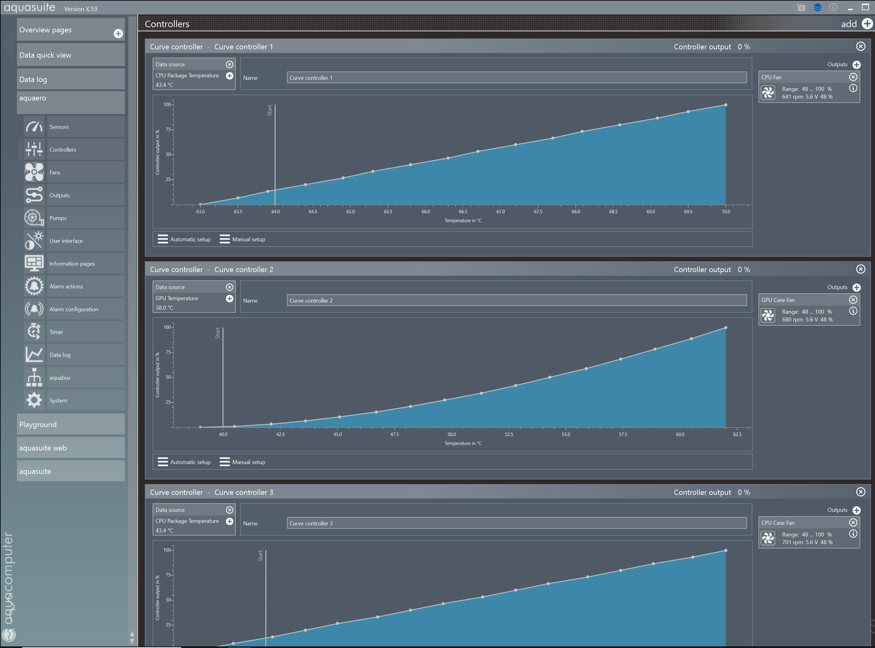

Hey guys!
I'm thinking on getting either Quadro or OCTO.
At the moment with my Aquaero which is probably decade old I'm using 3 fan channel for 4 fans which 2 of the fans from NH-D15 ( NF-A15) are on splitter connected to one channel. All my fans are controlled via Power Control (3pin) and configure in Curve Control according to my hardware (CPU and GPU) temperatures that are all I really use.
Would and of those 2 controllers have similar UI in Aquauite ?
Thanks
»Dundys« hat folgende Bilder angehängt:
Dieser Beitrag wurde bereits 1 mal editiert, zuletzt von »Dundys« (24. Oktober 2022, 02:41)
