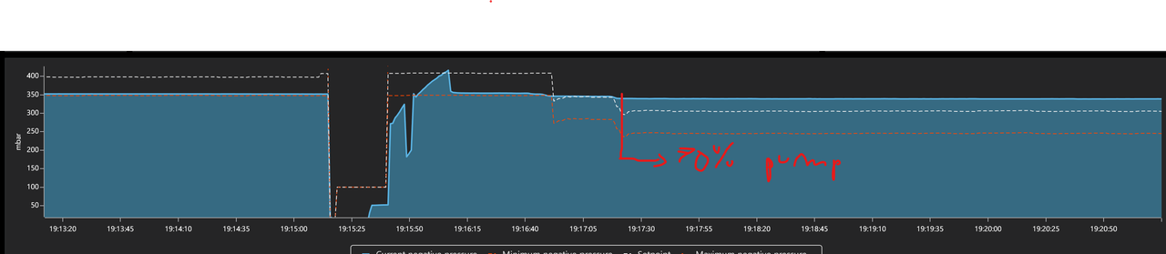

Hello,
I have some issues with leakshield. It would be great if you could help me solve them.
I didnt have some of these issues when I had the flow next sensor in the loop, but I stopped using it because it had its own issues e.g. becoming noisy when water temperature hits 35 degrees
  • Every time I shut down the PC, I get a leak alert. It's like it's not understanding that the d5 next pump has shut down
  • It'll throw an alert when the d5 next pump goes to a much lower power level.

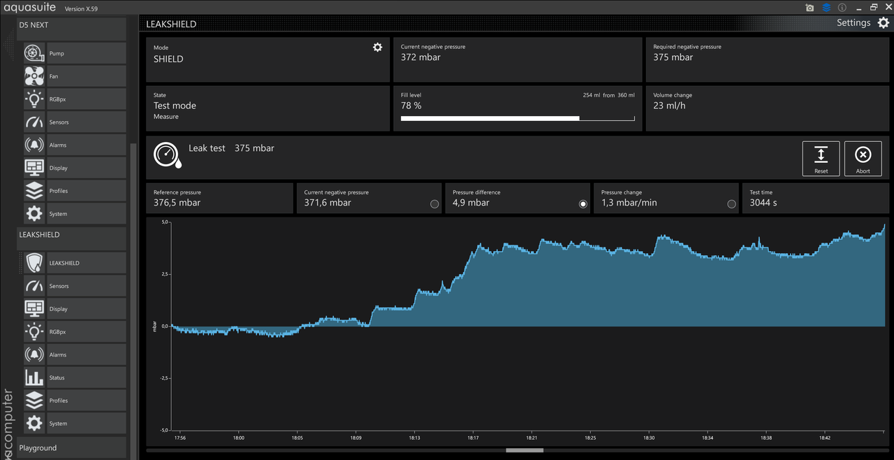

  • Leak test is not holding negative pressure about 400, while at 375 it looks almost stable
  • When establishing pressure during shield setup, it'd stop and throw an alert that the pump was triggering too often, so it must be a leak... but the pump was triggering often because it had to do a fill up test and then establish operational negative pressure, picture below. I can fix that by manually lowering minium negative pressure to something lower than the current negative pressure

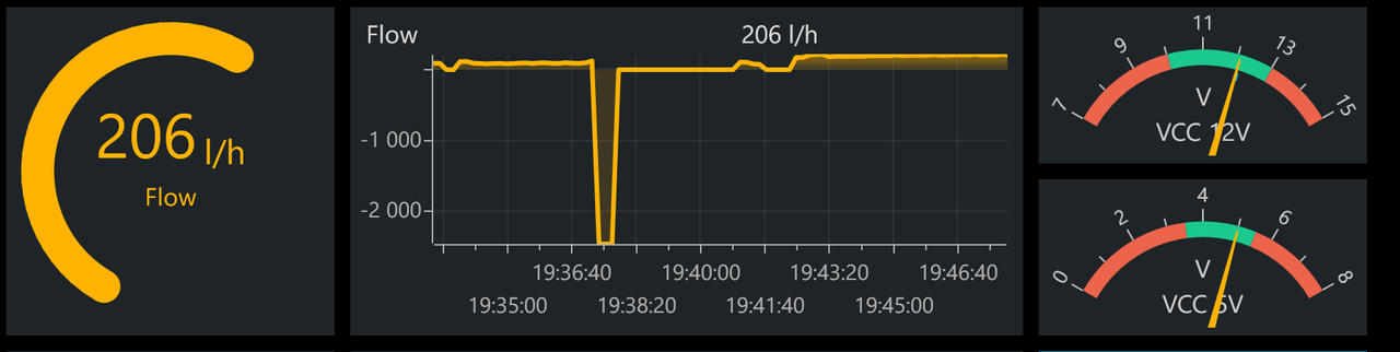

That was as excellent tip about calibrating the pump. I have managed to calibrate it and additionally using an offset of 25% it's only off by 10% from the real flow. Before it'd show 90 l/h, and now it stays around 200 l/h which is not bad at all for a virtual sensor. The flow next sensor would show something around 225 l/h at that speed. I'll try to drain some of the water tomorrow and see how that works. Thanks a lot for some great suggestions.

  • I have increased the air volume to like 30%+ (leakshiled shows 92% filled, but that's wrong)
  • I have calibrated the virtual flow meter
  • the system is completely vented
  • Just take a look at those leak tests screenshots. It's a very small air leak over 2000-3000 seconds. At 375 is almost stable. I was hoping someone could tell me if that's normal. I've found many mentions in this forum that a small pressure leak is expected because of e.g. temperature, pump speed, no system is 100% airtight
  • Air doesn't visibly collect anywhere after overnight with the shield on
I think those are software issues. I have managed to solve one of the problem when setting up shield would cause an alert. There is a dip in pressure after the shield has established pressure, which would cause an alert straight away. I have manually changed the minimum pressure from 375 to 300, so the dip can't cause an alert any more.

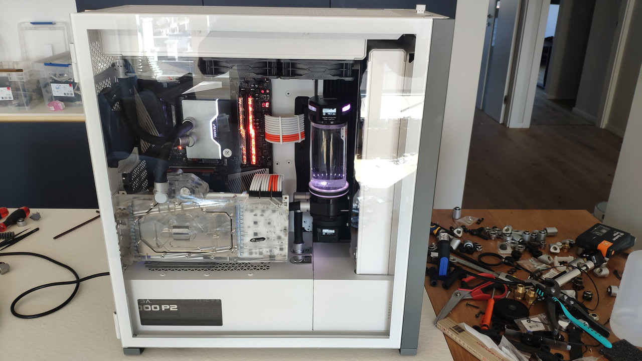

You should give us some more information.
First of all, Aquasuite has a small camera in the upper right corner, so you can take a picture of the whole window, not just a diagram.

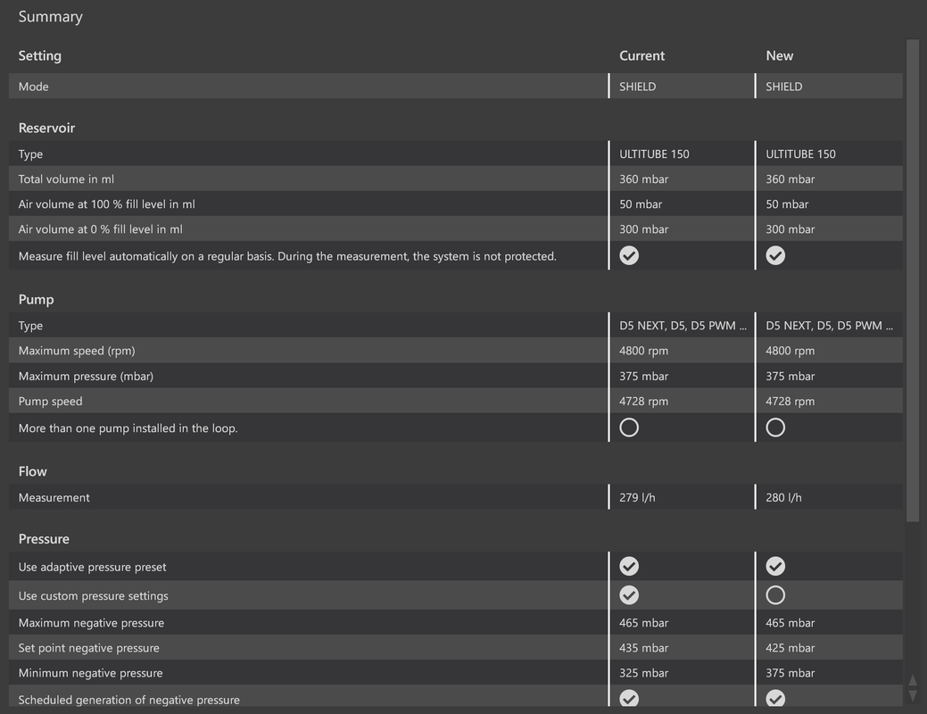

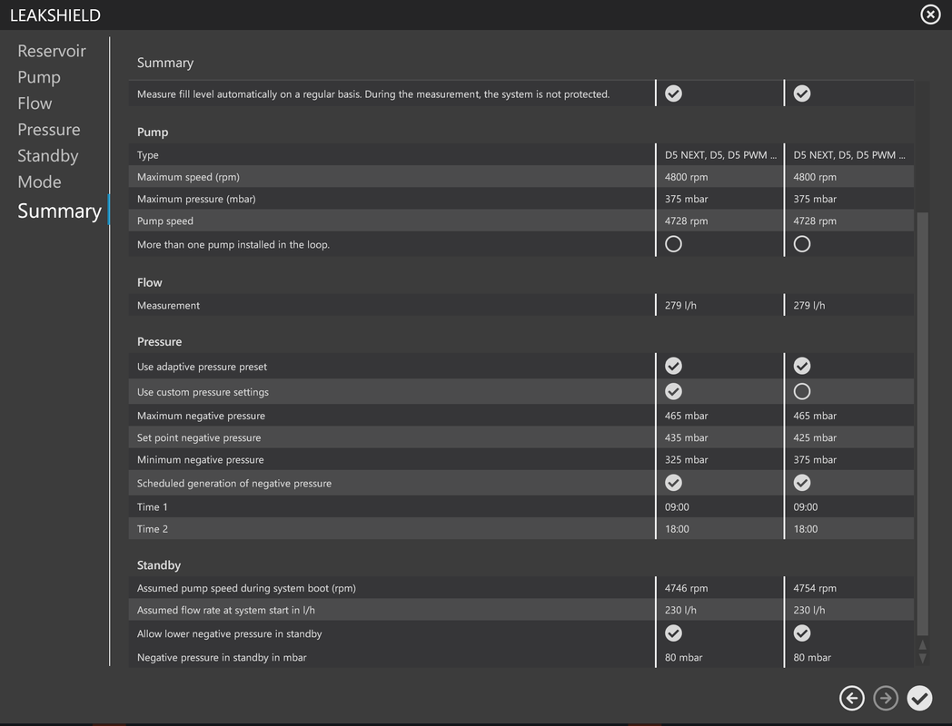

Then it would be quite helpful if you would post the configuration of the LEAKSHIELD, without that it is also hard to say anything.
Made a totally fresh default configuration for leakshield, using ultitube 150 defaults + adaptive pressure

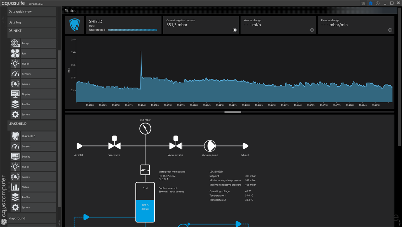

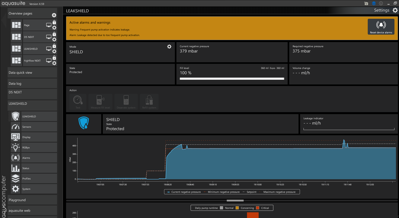

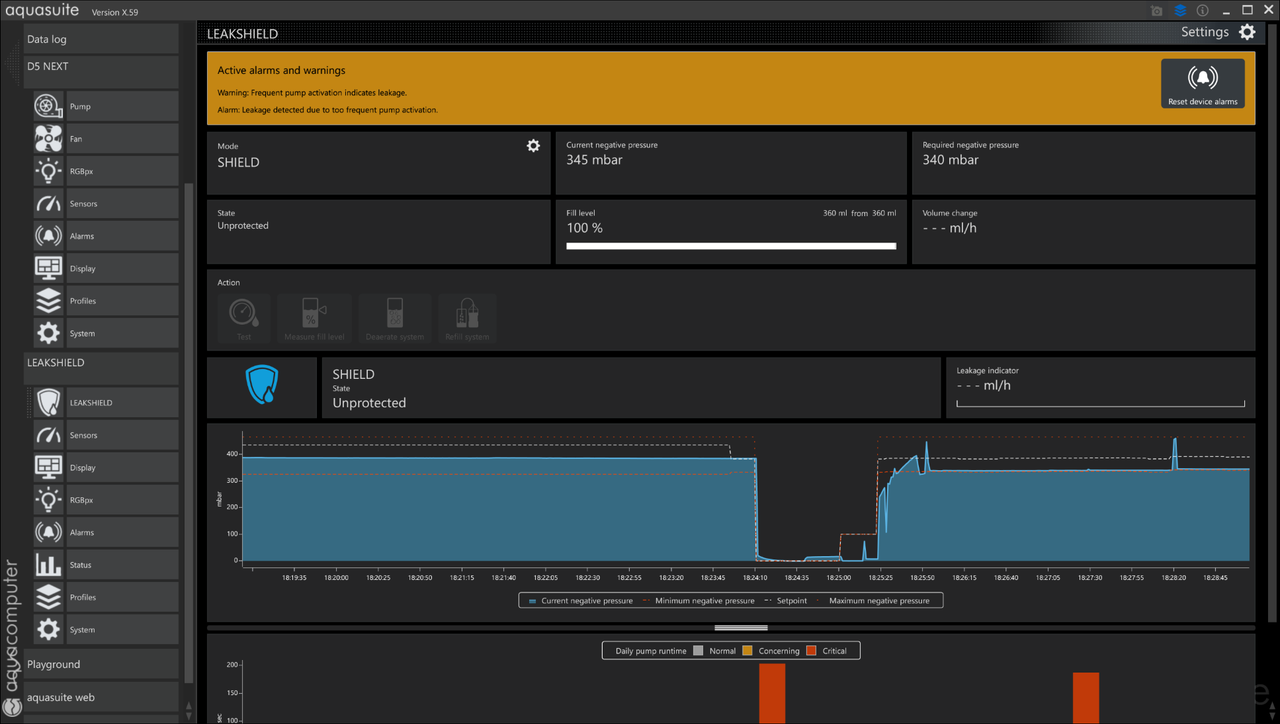

Then also a picture of the status page would be very interesting.
status page of leakshield :
status page of d5 next :
Replicating the shield setup issue again

You do realize that the LEAKSHIELD has very little headroom with these settings?
At 100% pump speed and 375 mbar pressure from the pump, the LEAKSHIELD inevitably reacts very quickly, since the system can only be protected with an overpressure above 375 mbar.
Since the flow rate values do not help you, I would rather go to a value around 100 l/h, then the pump generates a much lower pressure and the LEAKSHIELD has more headroom.
With the status page I meant the one in the Aquasuite under LEAKSHIELD.

I've fixed that already before by lowering the minimum pressure to 325 in the configuration. I've done a fresh default configuration to showcase the problem to you and removed my configuration changes from affecting the results.
Here's the picture :

Your LEAKSHIELD membrane is clogged which causes the pressure drop after establishing vaccum.
Do the clogged membrane there is a big difference between the vacuum in your loop and the LEAKSHIELD itself. The solution ist to clean the membrane or exchange it.
Cleaning can be done by adding some drops of isopropanol to the membrance surface, wait a few minutes and remove it with a tissue. Don't touch the membrane with the tissue, just remove the isoprpanol.
Do this a few times (up to 10 times) to clean it.
Additional you should exchange your coolant. We noticed that this often occurs with the EK ZMT tubing but we have currently no idea why. If this tube is just EPDM it should be clean and shouldn't issue any softener issues.
Less than 1% of our LEAKSHIELD customers have issues with clogged membranes. But after exchaning the cooland it should be mostly solved.
