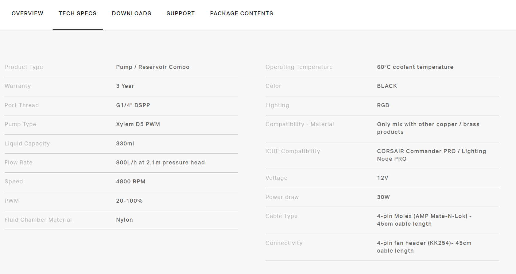

I am using the Corsair (Yeah, yeah I know) XD5 Pump/res combo, specifically This one, I have attached a photo of the specs as well to save ya'll a click.

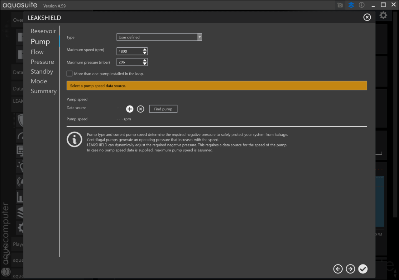

Per my understanding, it looks like the rated pressure listed under flow rate is 2.1 m pressure head... which I believe roughly converts to the 206 minimum mbar I have set under pump parameters. The wizard calculated and adjusted the other parameters under pressure accordingly (see attached screenshots).... Does this sound/look correct are the pressure parameters too high? I almost feel like this is too low? Maybe I am overthinking it though.

Corsair uses a D5 pump, so you can select the first item in the settings for your pump.
For the D5 the settings are too low, it can generate 365 mbar under full load.
If your pump is not working at full load you can calculate the pressure with this formula:
NEU: LEAKSHIELD - das sicherste Flüssigkeits-Kühlsystem der Welt
In addition, I would use a custom print profile and turn off adaptive matching.
I have set the minimum pressure in my system to 310 mbar, my pump is at 254 mbar, so I am sure if something should happen, the set point depends on the tightness of your system and how often your LEAKSHIELD should pump. I am at 420 mbar, but in a tight system it can be lower.
