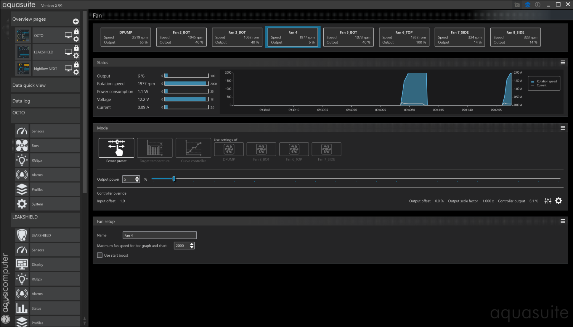

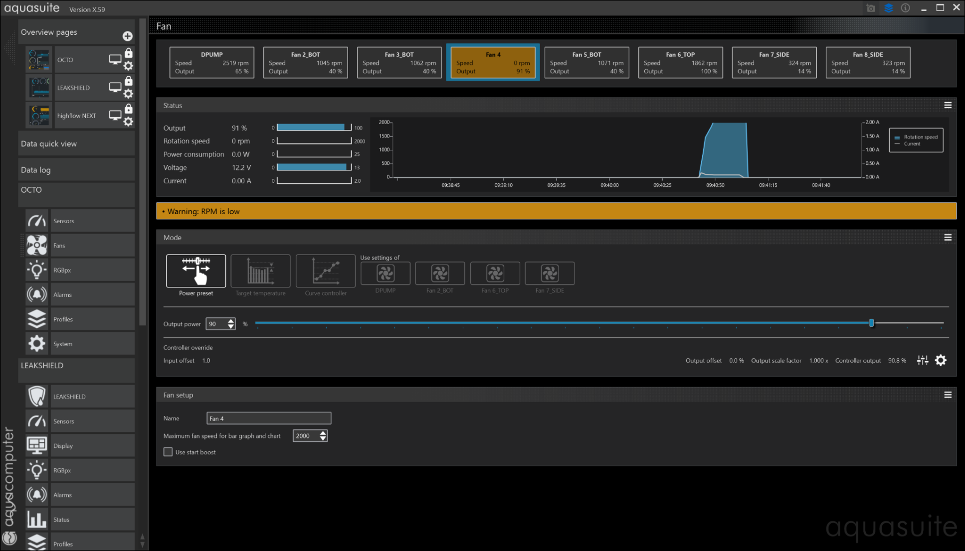

Hello Everyone,
Amazing Octo, Leakshield and High FLow impressed me every times, controlling fans at ease. I will share the snap of PC soon. :)
After a few weeks, One fan 4 acts in surprising way as RPM is going to increase at 10% and decrease at 90% :/.
I tried to reset the controller, but it is still the same. Please have a look at 2 images. Is there any way to fix the solution?
Please help!

Samstag, 24. Dezember 2022, 18:12
Have you tried swapping fan 4 with fan 3 or 5 to see if the issue follows the fan or the port?
sworfiss
Samstag, 24. Dezember 2022, 20:33
Yes I had swapped different fans on 4 port, Reversal issue appeared. I even set one follow to another port, but same issue
Samstag, 24. Dezember 2022, 22:35
Inverted control without input offset is something I have not experienced.
You mat be best served contacting support: support@aqua-computer.de
sworfiss
Sonntag, 25. Dezember 2022, 05:55
Sure, Ill mail it. Thanks
