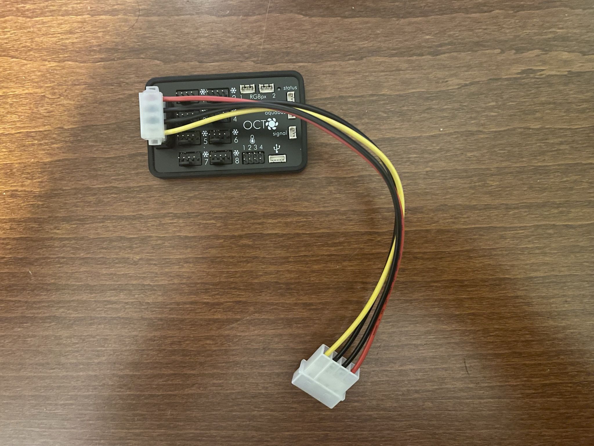

I am thinking about relocating my Octo, Farbwerk360's and Hubby7 to the rear panel of my case. They would be easier to access verses where they are now. Unfortunately, the height of the Molex 4-pin power connectors that plug into the Octo and Farbwerks prevents the case side panel from going on. I searched around for a Molex 4-pin 90° adapter but could not find one. I did find Molex 4-pin 8-in long extension cables that have a 90° female connector on one end. LINK From the picture, I suspected that the 90° bend went the wrong way but I decided to take a chance and ordered 3 of them. I was right. The 90° female connector has the 4 wires existing the "wrong" side. The photo I attached shows what I mean. It's the same for the Farbwerk360, but the 4 wires don't really obstruct the ports on the Farbwerk. They do obstruct ports 1, 3, and 5 on the Octo. Does anyone know if they make these 90° Molex 4-pin female connectors with the wires exiting the other side, or better yet a small male to 90° female adapter? This would allow me to have a low profile power connection to these devices which would not prevent the side panel from latching into place.
Upon closer inspection of the 90° female Molex connector, it looks like it consists of 2 pieces snapped together. If I can get them apart without breaking it I may be able to flip the contacts around so the wires exit the other side. Then I need to make sure that +12VDC and +5VDC conductors are in the correct locations. I think pin 4 is closest to PWM port 1 and is +5VDC, and pin 1 is closest to PWM port 5 and is +12VDC. Is this correct?

Can't tell from looking at the picture if the cap on the 90 can be reversed.
If so, swap the wires to come out the opposite side and reseat the cap.
If not, ModRight has with two 90s.
Snip the wires behind the first connector to make it single.

Or you could make your own with some of THESE (End Cap Type)

Or This which is SATA to Molex

Thanks for these good ideas! I could buy the connectors and the contact pins & sockets, and a crimper, and make my own. I could probably get away with not buying the proper crimper since I only need 3 of these.
I considered SATA to Molex adapters but Aquacomputer put Molex power connectors on the Octo and the Farbwerk360 because the Molex connector has a higher maximum current and power rating than a SATA power connector. Both of these devices can pull a lot of current - the Octo has to handle 8 PWM ports at 2A each, and 4 RGBpx ports that could have up to 90 LEDs connected to each. The Farbwerk360 also has 4 RGBpx ports and can pull up to 8A on the 5V rail. I think a SATA power connector is limited to 4.5A on the 5V rail. In reality my loads would not hit these maximums so it would probably be fine. I am also considering how the various loads (pump, 2 x Farbwerk360, Octo, 2 x Hubby7 and an NZXT internal USB hub, 2 Corsair Lighting Node Cores,7 RGB fans, 2 USB powered internal stat displays, 756 LEDs, and several PCIE SSD drives) is distributed across the various outputs of my PSU. It adds up!

Update - SUCESS!!
I was able to pull the connector "cap" off, putt out and flip the wires. After the obligatory re-pinning it the wrong way the first time, I now have the connector flipped 180°. I was not sure if I needed to flip the 2 black wires. One is the ground for 5VDC and the other is the ground for 12VDC. These are probably common in the Octo and Farbwerk360 but I was not 100% sure if they are common at the PSU end. Being ground they should be, but sometimes multiple power supply grounds are bussed together at a specific point in the circuit so I went ahead and flipped them in the connector so I don't need to worry about it. I tested continuity and will double check that I have 5VDC and 12VDC in the correct positions before I plug these into my Octo and Farbwerk360's.
