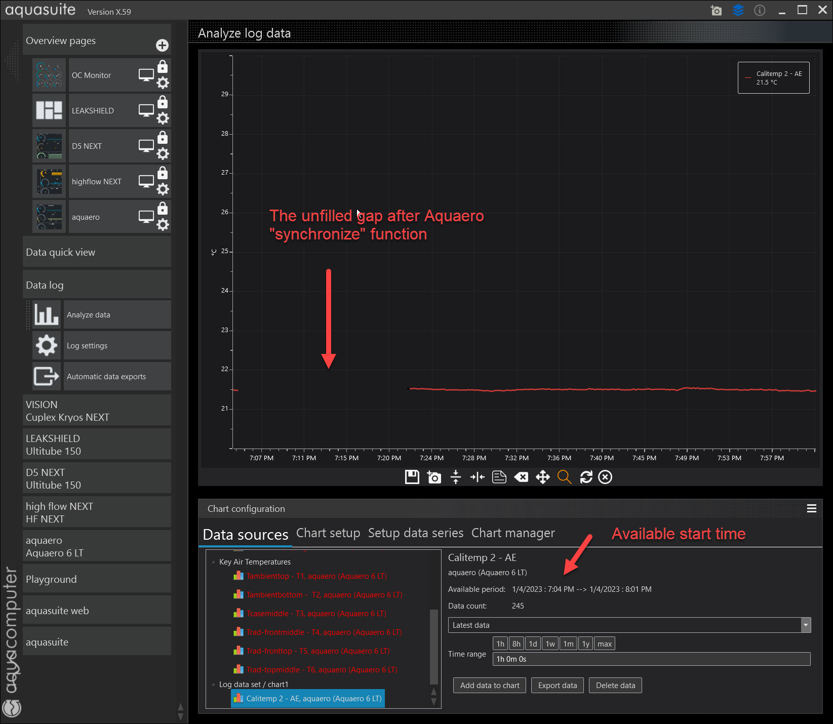

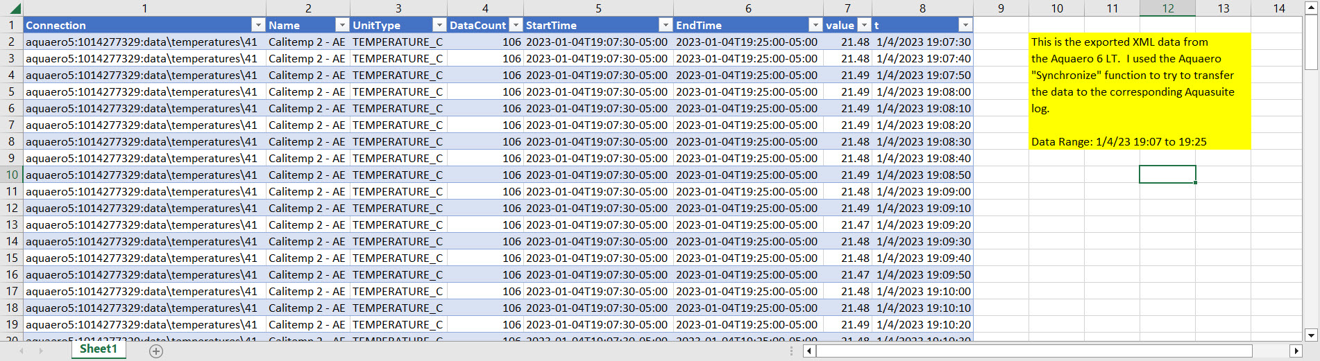

A picture of the Aquaero XML data is in the attachments.

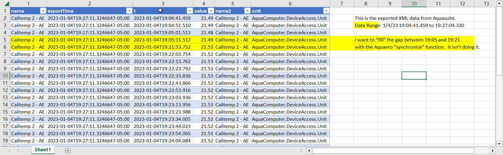

A picture of the Aquasuite XML data, after the Aquaero synchronize, with the gap, is in the attachments.

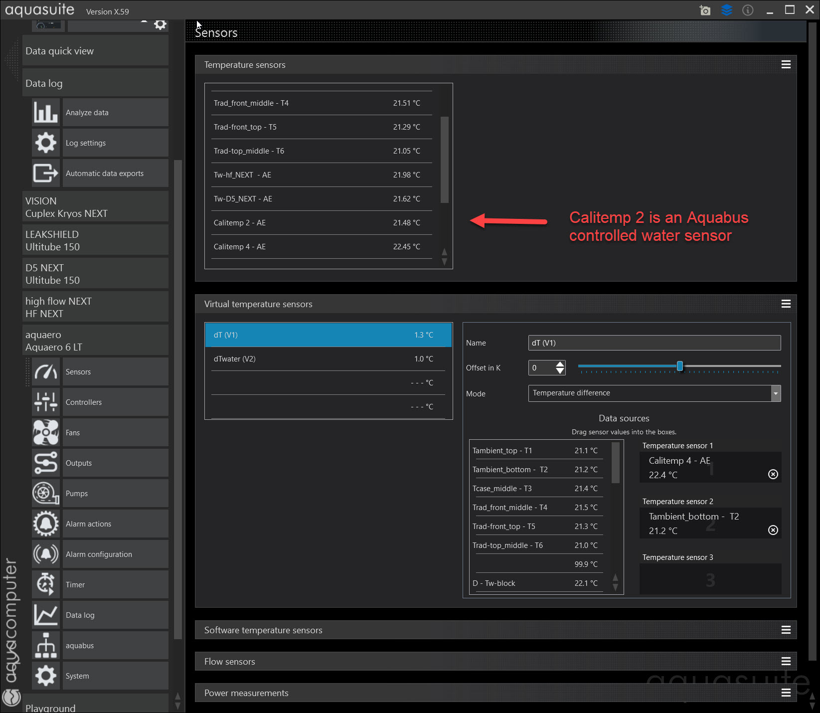

Attachment 1 – Aquaero – Calitemp 2 – AE sensor configuration

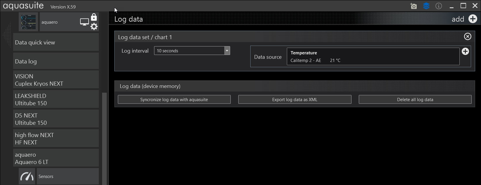

Attachment 2 – Aquaero – Calitemp2 – AE data log configuration

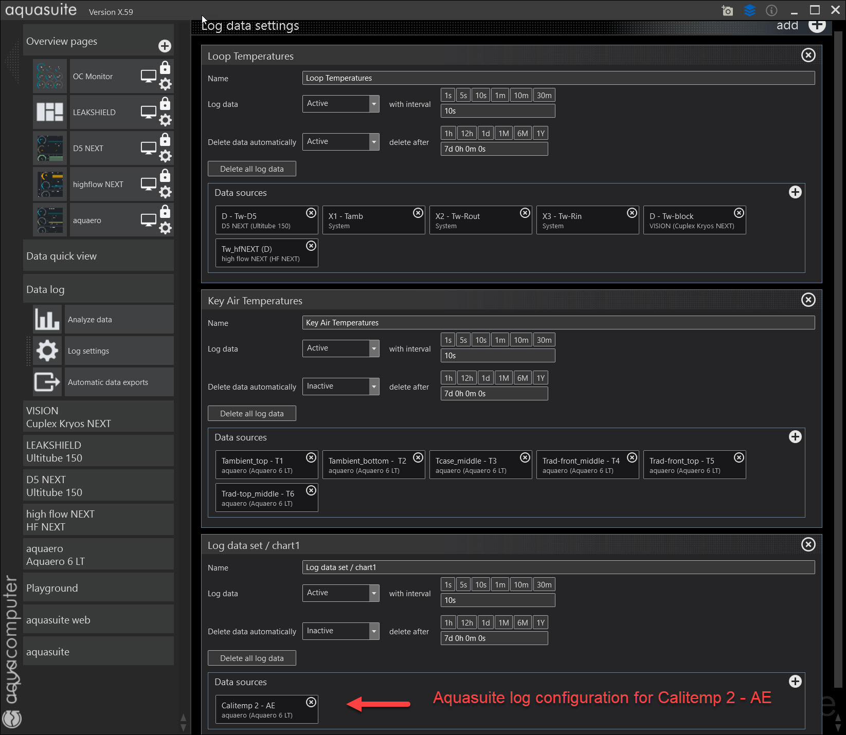

Attachment 3 – Aquasuite – Calitemp2 – AE data log configuration
Attachment 4 – Aquasuite – Unfilled gap after Aquaero synchronize
Attachment: XML Data - Exported from Aquaero 6 LT
Attachment: XML Data - Exported from Aquasuite - Calitemp 2 Data Log
