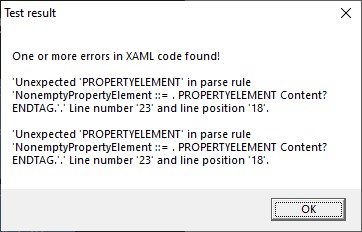

When I check syntax, I get a number of errors: (attachment Check Code.jpg)
apologies for the snip, it's the quickest way I could think of to get the dialog info into the post. I've been caught up at work and therefore a little tardy with trying this code on my machine.
It appears to be an error on the line, and I'm not familiar in XML in any way. (R, Python, C, 6800 ASM, + many other 'old school' langs I've used, just not the new ones!)

Freitag, 24. Februar 2023, 07:27
Any ideas on how to edit the control's xml code to add two decimal points? The relevant code (I think!) is this:
ConverterParameter="2"
Sets the Parameter to 2 == 2 decimal places.
StringFormat is not working when you use an converter.
BigTrev
Mittwoch, 15. März 2023, 00:25
Thanks,
That fixed it!
