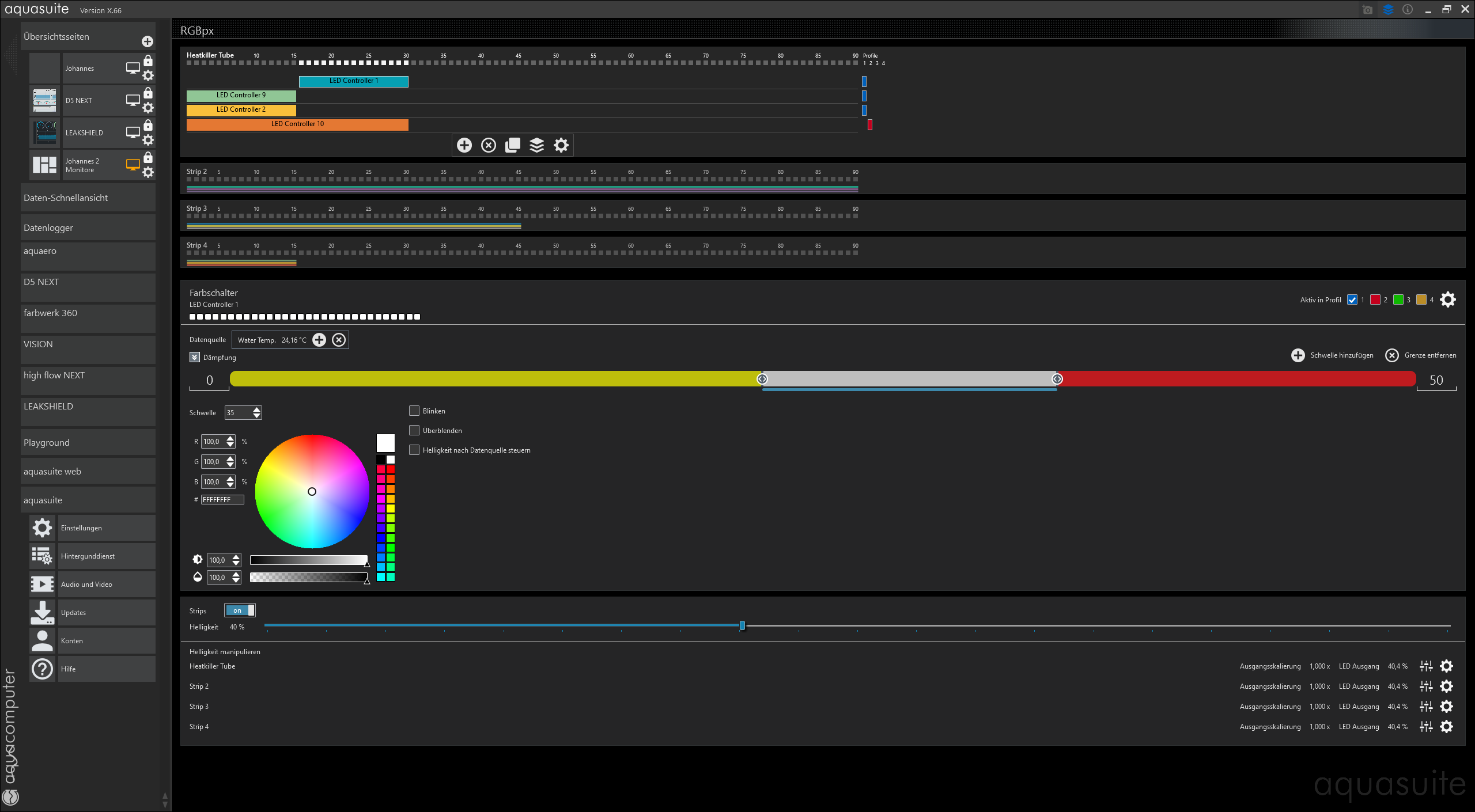

Hi Guys
Has anyone figured out how to reflect coolant temperature on the Farbwerk 360 light strips? eg, green for coolant temp up to say 40c, 40 to 50c strip (or part of strip) goes yellow. and over 60 degrees strip goes red??
Many thanks
Freitag, 24. Februar 2023, 12:42
Just configure the controller as a color switch, it will look like the picture.
»Taubenhaucher« hat folgendes Bild angehängt:
mocha
Freitag, 24. Februar 2023, 15:21
Thank you, just what I was looking for! :-)
