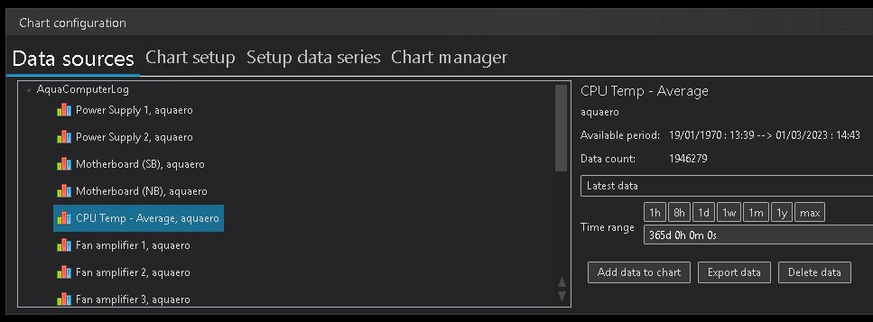

Have just updated to aquasuite x59 on one of my machines, but having some issues getting log data to show up in Charts. The data seems to be there, data count for each of the sensors under data sources shows there is data there, but when i go to load one of my charts under Chart Manager, it only loads data since this morning when I updated. I have charts for 1week, 1month and 1year setup, all the same. Also tried creating a new chart and have the same result there, just loads data since I updated aquasuite this morning. Tried both with latest data, and a time series selection, same result.
I've checked the C:\ProgramData\aquasuite-data\aquasuite_db.database location and seems like that's where this gets stored, and have never had any issues in the past through multiple aquasuite version updates the logged data and charts has always just been there after updating, so little confused as to why it isn't just working this time around. I can see there is also a backup of the db created there also, just prior to the update to x59. It's quite a large db now at 557MB. I also took a profile backup manually via export and restored this as normal, and backed up my log settings file as well just in case. All seems to be as it should be having cross checked all the settings and log settings menus, all as it was before the update. It seems as if historic data in the .database blob just isn't being read at all :(. Just need some help figuring out why.

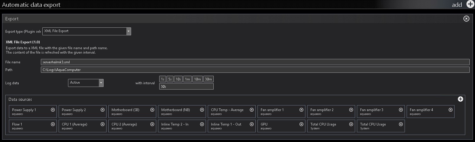

Automatic Data Exports Screengrab:
ATTACHED

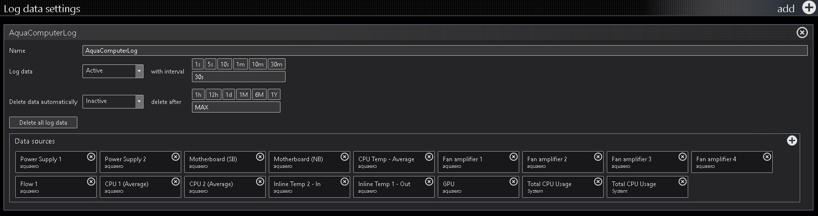

Log Settings Screengrab:
ATTACHED
Data Sources Screengrab for sensors showing data count (all sensors have data):
ATTACHED
