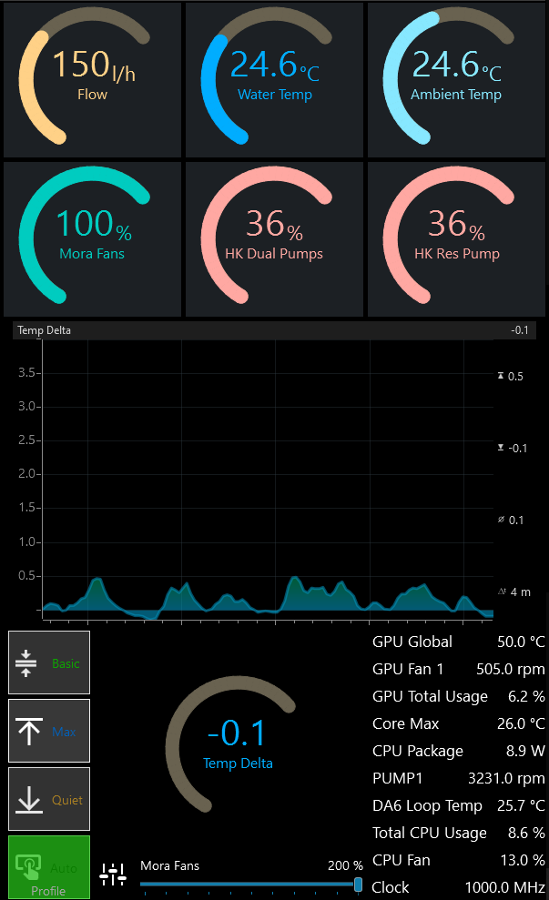

In particular, I have some complex logic virtual softare sensor for auto-levelling flow rate, and a touch panel display config that took me a long time to get even this far
»L0wPull« hat folgende Bilder angehängt:

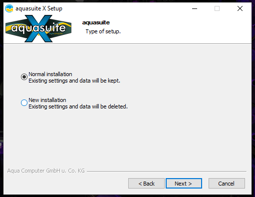

Very happy to report the reinstall happened with no problems at all.
Zipped up the C:\ProgramData\aquasuite-data as instructed before OS reinstall.
Extracted contents back to same directory after windows install, before launching AquaSuite install - upgraded to latest version also X68 from X59 IIRC.
During install you're prompted to keep settings or clean install, choose keep settings, enjoy! :)
ty again for the help!
»L0wPull« hat folgendes Bild angehängt:
