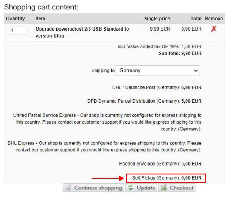

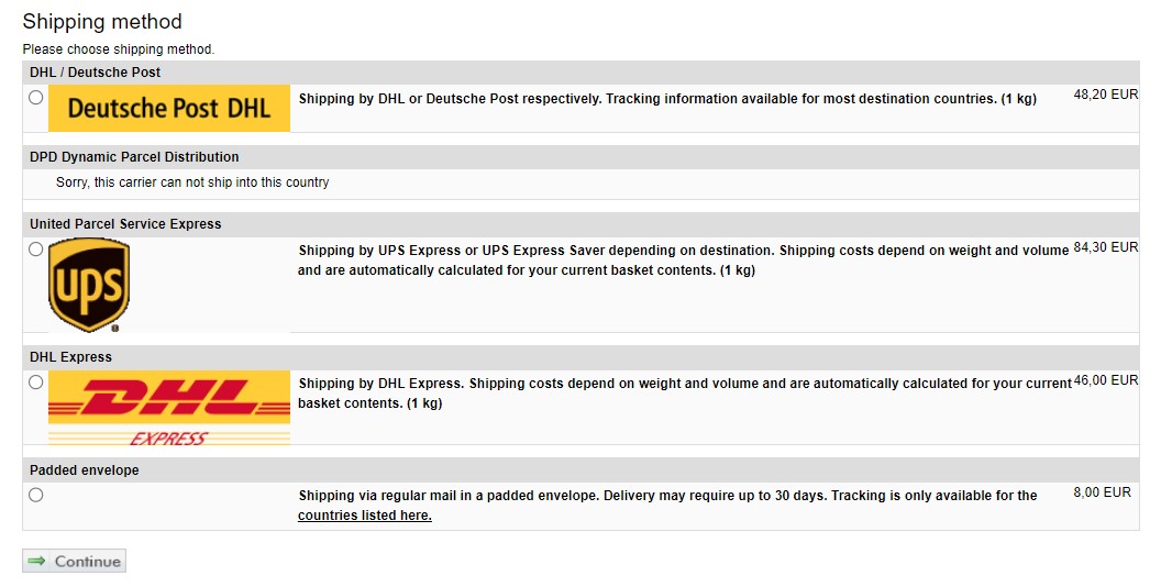

Edit to add - Well I tried to buy an upgrade key but the instructions say if you are only buying the key, select Pickup as the shipping method. I don't see this option in the shipping section. This may be because I have ordered directly from Aquacomputer before and since I am logged in it shows my shipping address in the US. I tried changing the destination country to Germany. Then I see the Pickup option in the shopping cart but when I go to check out, there is no Pickup option. There is also no Pickup option in the Shipping To pulldown menu. Hopefully someone from Aquacomputer will read this post and explain to me how to specify the Pickup option when buying the upgrade key. Until then, I am stuck.
