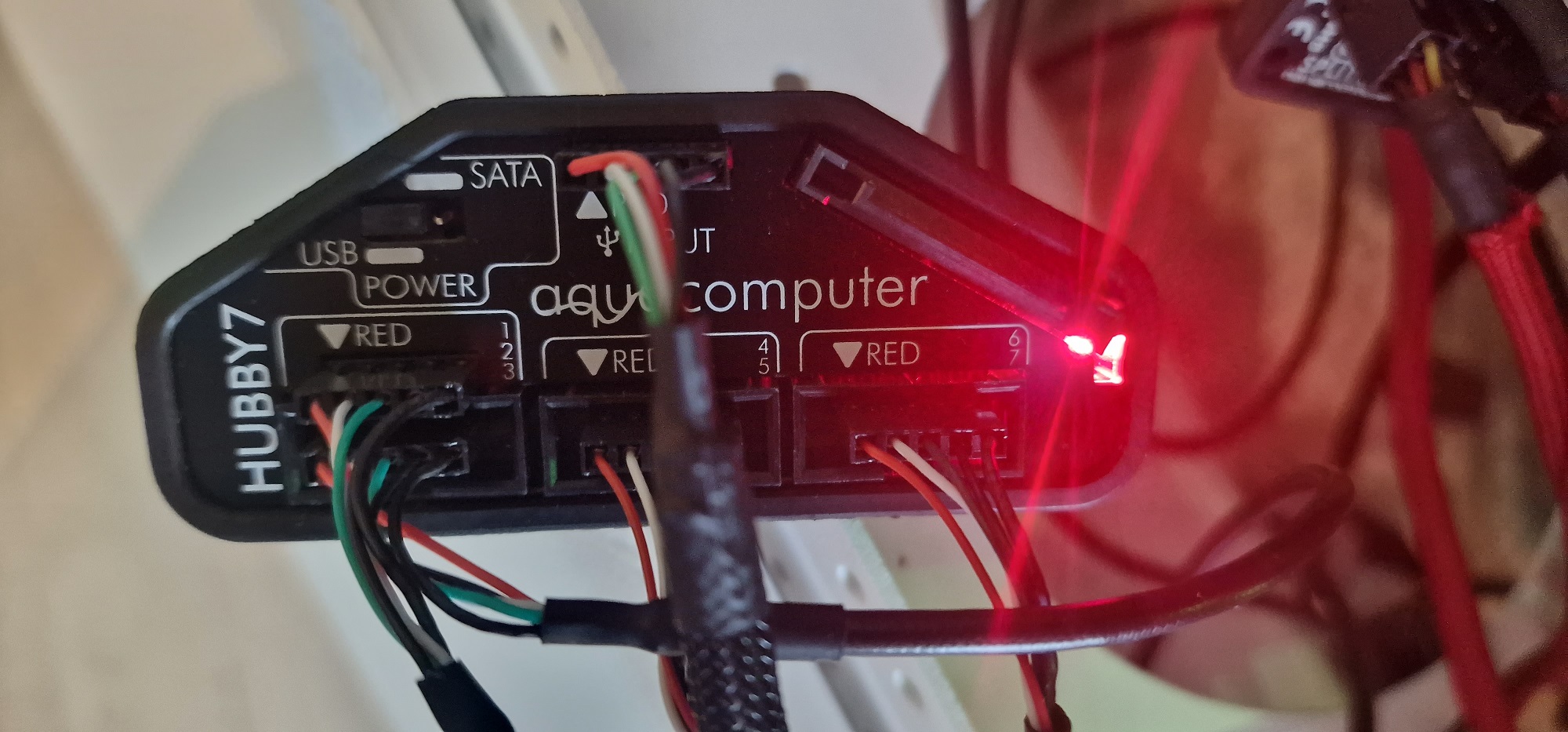

make photos from your wiring and your connections.

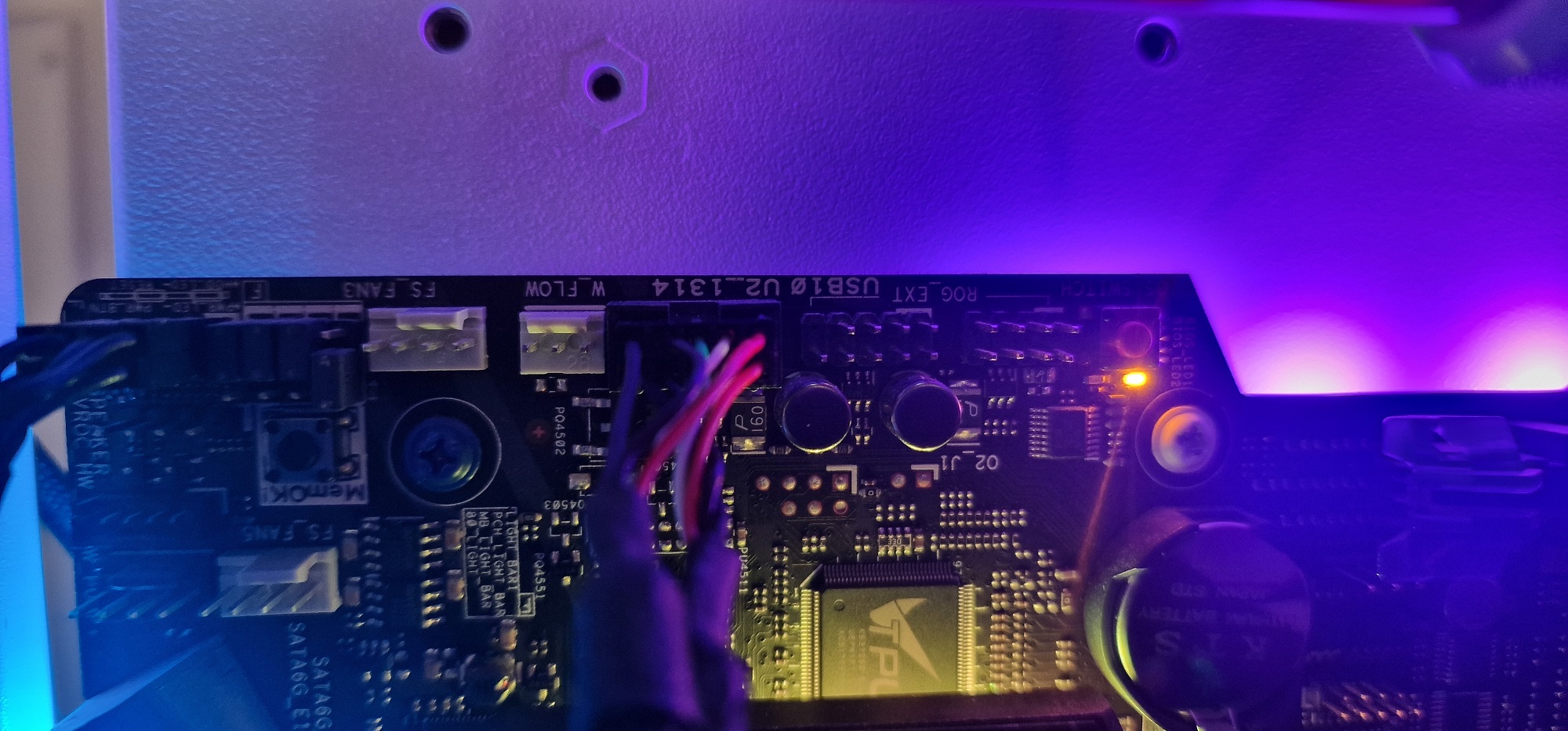

ok here the photos of the USB motherboard connector and the hubby7.
On this hubby7 i have the leakshield, highflow next, farbwerk and the D5 Next pump from my ultitube.

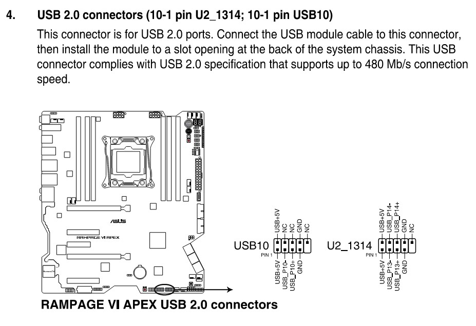

On my Asus Rampage VI APEX i have only one USB 2.0 connector. My USB cable are perfectly connected and jumper set on the good position.
I am not sure what your problem is with the Hubby7's but I clearly see 2 USB 2.0 9-pin headers on your mobo in the first picture. I looked up the Asus Rampage VI APEX and the Owners manual clearly shows 2 9-pin USB2,0 ports. In your second photo of the Hubby7 I don't see anything plugged into the SATA power connector. When you switched the Hubbby7 jumpers to SATA, did you connect SATA power to the Hubbys?
What do you mean by "jumper set on the good position."?

The sockets on the hubby7 are not a tight fit, and the plugs can be inserted offset.
In your picture it looks like ports 1 and 3 are shifted to the left, and port 7 may be shifted to the right (may be parallax). Port 5 looks properly centered.
As Speedy-VI pointed out, it appears you have two 9-pin sockets on your motherboard, giving you 4 USB ports.
I would set them up as follows:
  1. leakshield #1
  2. leakshield #2
  3. farbwerk 360
  4. hubby7 (not sata powered) add the rest to the hubby7
    aquaero 6
    both highflow next (do not use rgbpx ports)
The leakshields can draw up to 500 ma and should have their own USB port
The farbwerk 360 can also draw high current if leds are maxed out
The reason to not use sata power for the hubby7 is the aquaero and high flow nexts have functions they can do while the system is powered down.
The USB connections from the motherboard retain their 5V output, whereas the sata connection does not.
Keep the 2nd hubby7 for future builds.

When i say the jumper is in good position, if i connect my Hubby7 on USB cable the jumper is in position 1/2 and position 2/3 for SATA power but if i understand what Sebastian write i need
to buy an adaptator to use my Hubby7 with SATA power but i never see that on the manual.
I know for internal USB port, i have the manual for my motherboard. But now i know the problem from the ROG forum. I have only one USB port 9-pin headers called USB1314 where i can connect
two different devices and the USB port called USB10 is just a unique USB port where i can connect only one device on the down pin header because the up pin header there is no function.

if i understand what Sebastian write i need to buy an adaptator to use my Hubby7 with SATA power but i never see that on the manual.
The adapter Sebastian mentioned is a USB3.0 to USB2.0 adapter. It has nothing to do with powering the Hubby7 with Sata power. You just need to move the jumper to the Sata power position and plug in a Sata power cable.
But now i know the problem from the ROG forum. I have only one USB port 9-pin headers calledUSB1314 where i can connect two different devices and the USB port called USB10 is just a unique USB port where i can connect only one device on the down pin header because the up pin header there is no function.
I don’t think the advice you got on the ROG forum is correct because the manual for your motherboard clearly shows that the USB10 header is wired just like the U2_1314 header. Personally, I would trust the Asus manual. The Dual USB 2 PCI bracket you linked has a 10-pin USB header on it so it would require a fully wired USB header for both of the ports to work.
If i have 2 Hubby7 is just question for cable managment and have one hubby for one loop, I have a Ultitube 200 pro leakshield each side of the case and it's more easy for me. This is why i want to connect all devices for a loop to one Hubby7 with SATA to have more power.
I still recommend that you connect 1 Leakshield to one port on USB header U2_1314 and the other Leakshield directly to a port on the USB10 header. You can then plug each of your Hubby7s into the other port on each USB header. This way the Leakshields pull power directly from the mobo USB headers instead of through the Hubby7, and those USB ports should stay powered up when your system is off (assuming you disable USB Selective Suspend in the Windows Power Management settings) If you set the Hubby7s to SATA power and plug the Leakshields into them, the Leakshields will lose power when you turn off the computer. It’s up to you. Good luck with whatever you decide.
The pin-out diagram you linked shows the upper port on USB10 having +5V & ground, but the data pins show NC (PIN-OUT)
The USB-Tree GhostR1d3r linked shows one leakshield on USB13 & the 2nd on USB14. The D5s were not on the original list, but it looks like s/he has what s/he wants. (USB_DEVICE_TREE)
Wow you’re right, and so was the info OP got from the ROG forum. Apologies for the confusion. I wonder why Asus would do this, especially on an X299 EATX high end motherboard.
