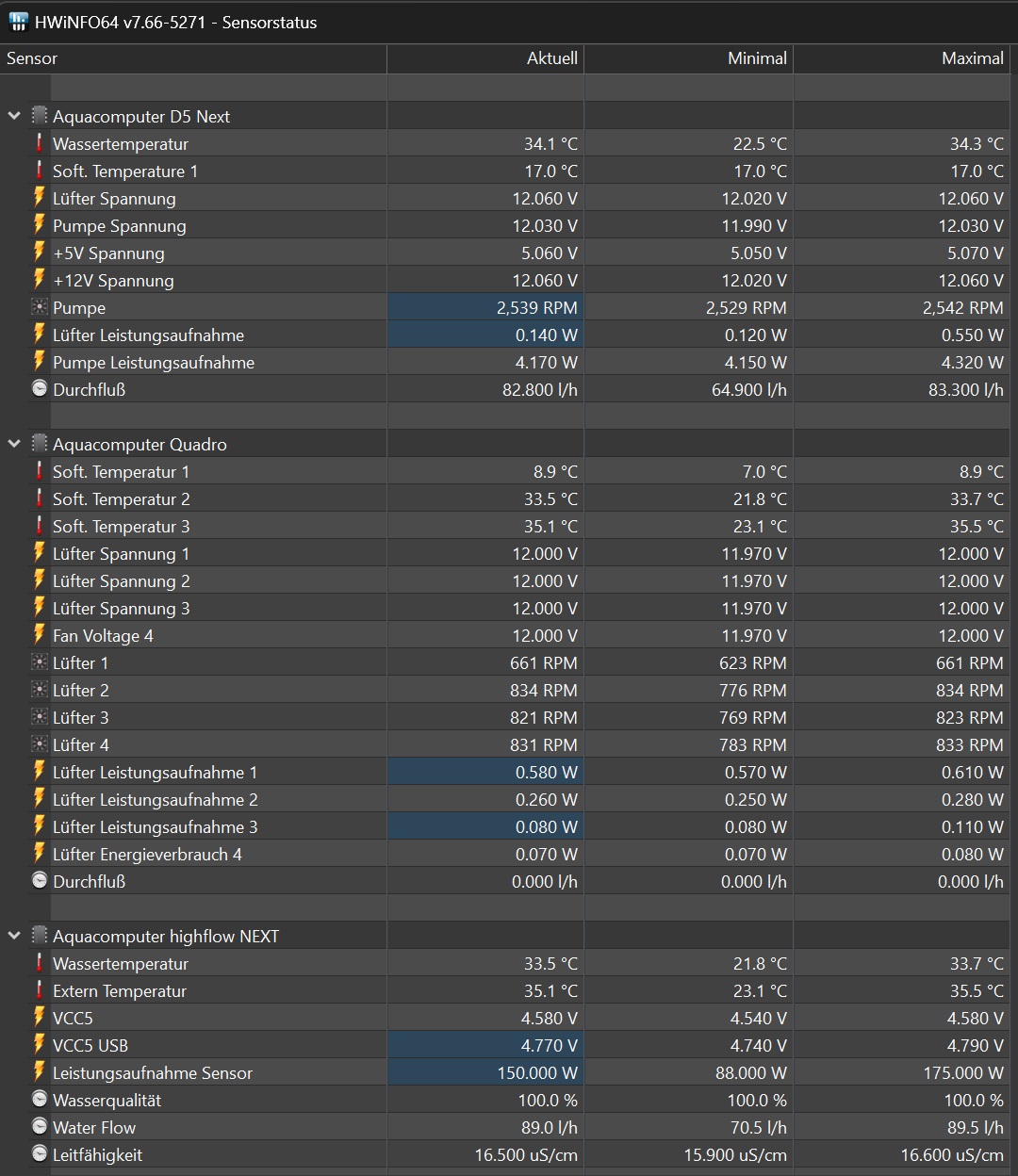

Yes, HWInfo64 can read the Sensors from the AC devices and the imported soft. Sensors of the device.
The virtual Sensors from "Playground" are not readable. There is no limit of 16 sensors
Here are the Sensors in HWInfo from my devices: HWinfo.jpg

You can read virtual sensors in HWinfo64 if you define them in one of the software sensor slots of one of your devices.
That's pretty handy since even RGB controllers like the Farbwerk360 has 16 software sensor slots. you have plenty available to expose your virtual sensors to HWinfo ;)
Here are the Sensors in HWInfo from my devices: [attach]10739[/attach]
