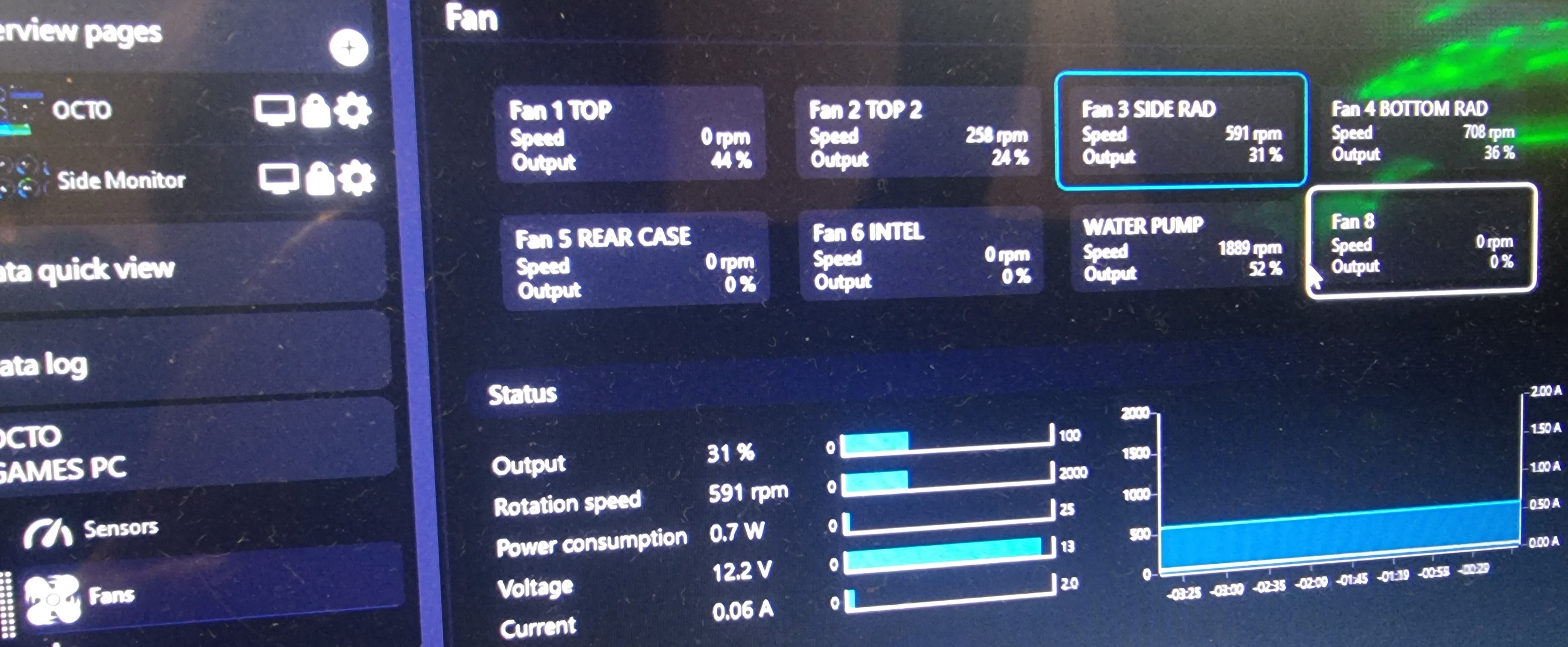

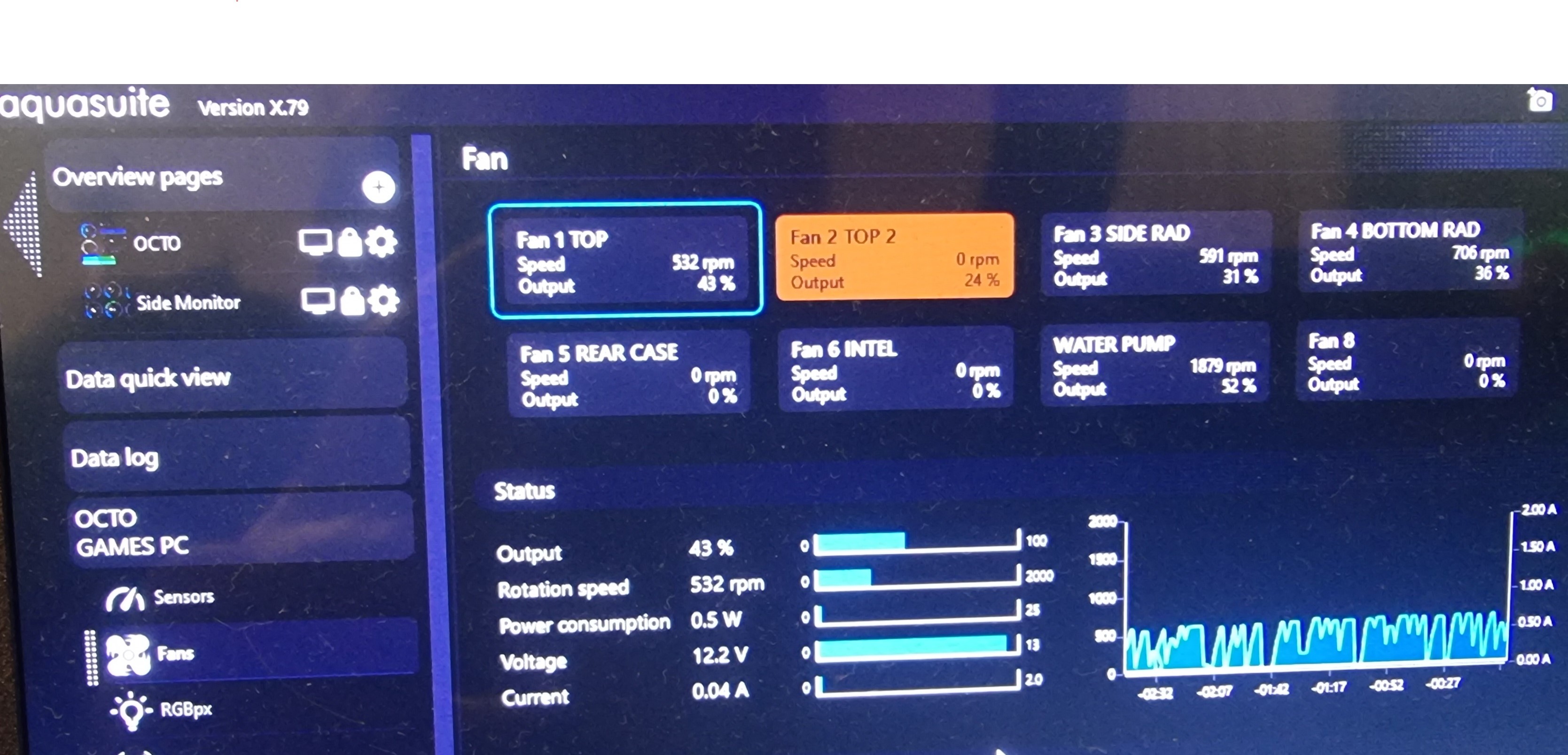

Currently running the 3 of the Noctua fans from one header on the Octo gives me ramping issues ( see first pic ) because the PWM signal is compromised, would only running two from an active splitty fix this .

Adding some pics , the one with the jagged fan profile is the three Noctua NF-F12 running from a 3 way spliiter to the fan header on the Octo , the other is the T30s run in banks of 3 with the flat profile , they are all
controlled from the water temp sensor.
The T30s seem to have no problem with the PWM signal on fan splitter cables , I thought the splitty9 active would solve this issue with the Noctuas but now I am not so sure . I am going to have to connect a splitty9 to
the Octo with 8 noctuas connected to 4 fan headers .
If that fails I will have to try one fan per header if that works then buy more Splitty9s if not then ditch the noctuas and buy more T30s or Arctics 120s .
