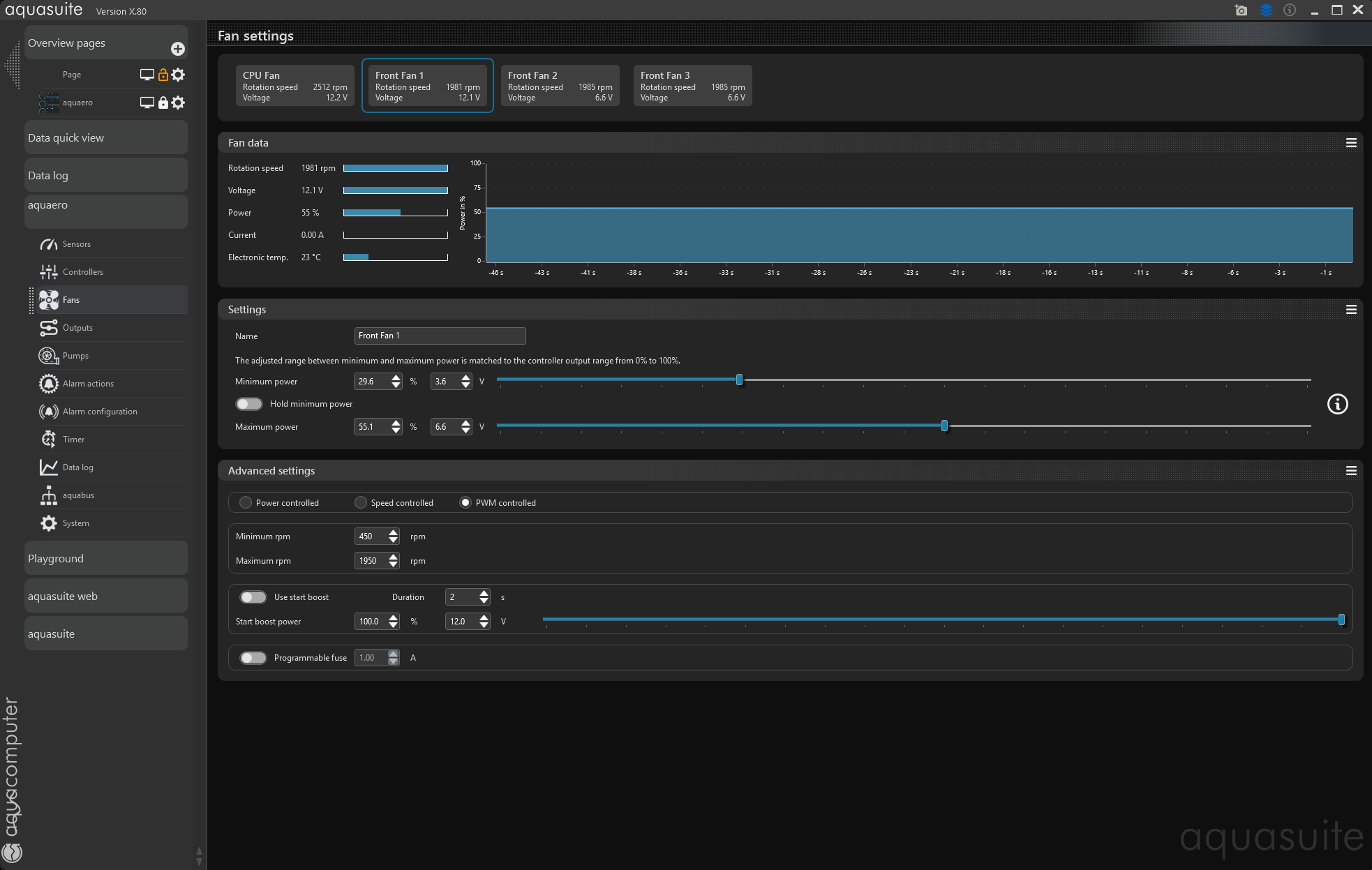

Aquasuite not showing fan curves
Samstag, 9. November 2024, 19:16
I am new to Aquasuite and I am not seeing any way to adjust the fan curves. There appears to be no fan mode section that i have seen other adjust their fan curve in. If anyone could give me any pointers that would be awesome.

It has been a long time since I used an aquaero, but look at the option in the menu above 'fans' labeled 'Controllers'.
I believe you can define your controller there, and then associate the fans you want to control, to that controller.

Thanks, actually ended up figured it out after a while. Thought it might have been an issue with my arctic fans as I read there were some issues there at some point. Didn’t realize it would be in a different location from what I’ve seen. Is that a difference between Quadro/Octo and Aquaero or just different location in newer version of Aquasuite?
Sonntag, 10. November 2024, 14:20
Yes, the aquaero is different from the quadro/octo, which have a controller for each pwm port.
