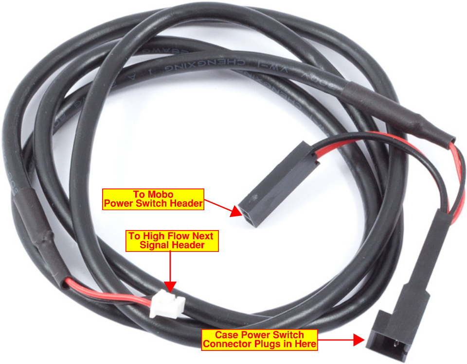

Then I have a low flow output (output actions) to send a shutdown signal to the PC if the flow sensor drops below a certain flow value. This is incase the pump fails (I have ek dual pump) or leak (heaven forbid). The signal works without a cable and is a soft off ( like if you tap the power button when PC is running).
I was wondering how you fit a direct cable connected to the power button header of the motherboard if its already in use! ?(

The Octo and high Flow Next have a Signal header that can be configured to output a temporary LOW (like a dry contact) across the pins. Cable #53216 plugs into the Signal header. The other end has a split cable - one side plugs into the Mobo power switch header. The wires from the case power switch plug into the other side. This puts the cable from the Signal header in parallel with the contacts from the power switch. I attached a picture with labels that show how this cable gets installed. When the Alarm is activated, the Octo or High Flow Next outputs a 1-second LOW on the pins which emulates pushing the power switch. I don't think the Quadro has a Signal header so it does not support this feature. To use it in this way, go to the High Flow Next Alarm tab and click the button for "Power Switch, switch 1 seconds at alarm". Connect Cable #53216 as shown in the picture. BE CAREFUL when you set up the Alarm. When I first did it, I made the mistake of testing it with a condition that occurred during startup. The result was every time I booted the computer, the Octo would immediately shut it down. I had to disconnect the cable so I could boot, then get into Aquasuite to change the Alarm trigger.
