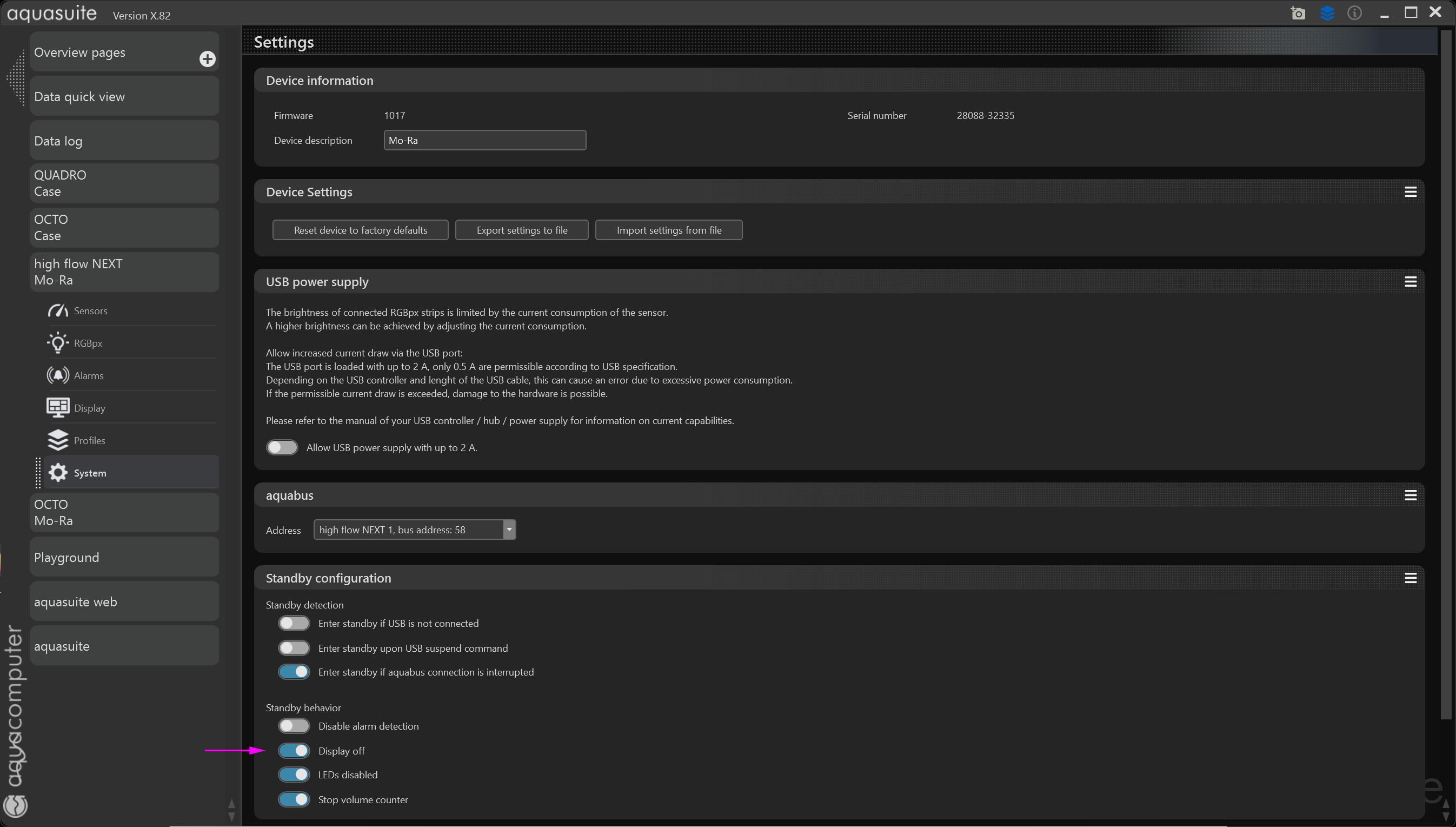

I just installed my new D5 Next and High Flow next. The pump works great but the flow sensor seems faulty or I doing someting wrong. The display on High Flow Next not switching on but the sensor is working. I have readings in aquasuite and hwinfo too, they seem to be proper readings. If I push the buttons have sound and the lighting works too only the display not switch on.
I tried it with the pumps usb cable but same problem.
If someone have some workaround I would like to know, or just send back the flow sensor. :)
Donnerstag, 6. März 2025, 04:41
Perhaps the 'Display' setting? [HFN_dispay.jpg]
As I have no aquabus connected, the 'Standby' function is always triggered, and the display is always off.
Coros
Donnerstag, 6. März 2025, 19:19
I tried it but not working. I send it back. But thanks for the help. :)
