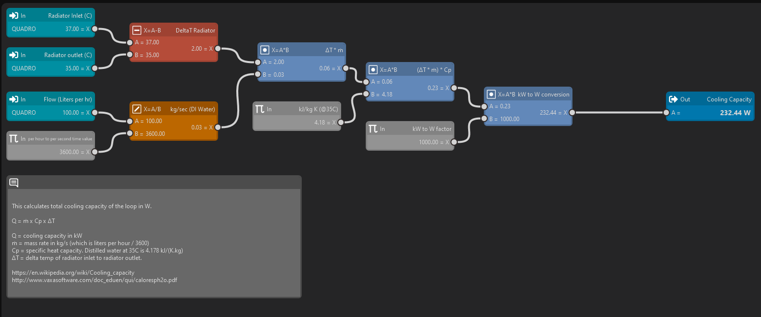

I want to manually make a calculation of power in the playground.
What is the equation I need?
RE: Added a temperature sensor but its connected to a qudro not high flow next.
Mittwoch, 16. April 2025, 01:59
The connection wasn't right so I connected it to the quadro. I see the temperature of the coolant in my loop after the radiators; and the high flow next is after the cpu & gpu block.
Here you go.

I guess its down the the accuracies of the temperature sensors. My value is currently zero.

I have my cold water readout higher than my hot water readout. I put that down to inaccuracy of the sensors. Aquasuite has the ability to offset the values but at that point it makes a calculation based on your own offsets. I have an air sensor which I find more believable against the hot water temp (after cpu+gpu block). I've just added my Mo-Ra IV 600 to the loop and that shows difference between the two sensors.
I'm also not using distilled water - so the calculation itself doesn't apply. Also not sure how litres get converted to kg in the calculation. All in all its a hot mess trying to calculate power dissipated.
I've got my Mo-Ra set to a target temp of 35'c and my internal radiators set to 36'c and my internals fans don't spin up above a minimum. Without the Mo-Ra the internals alone would end up 38'c at full speed. My flow rate has dropped 50lph to 300lph with a dual ek pump and a single heatkiller Mo-Ra pump. I have a 3m run to the external radiator.
Edit: Just changed my reading for the cold temp and now getting a reading. I'd say its all relative. I expect the cooling capacity to change when under load.

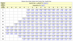

For glycol i found this table :
I arbitrarily use 30% concentration at 30°C on mine, so the specific heat goes from 4185 for water, to 3828 for the glycol mix. basically negligible for our use.
The flow sensor is somewhat accurate, but the NTCs are crap, and we don't know the exact % of glycol, so we just stack margins of error to get a very symbolic value ^^'
