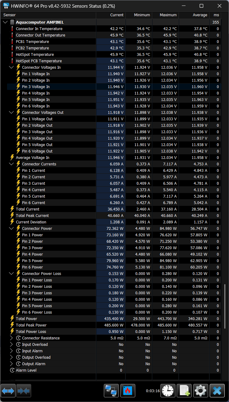

Already integrated and will be rolled out with the next HWiNFO update.
FLiNT
Mittwoch, 25. Februar 2026, 15:40
[attach]11336[/attach]
Any additional cables other than the internal USB one that comes with the Ampinel needed for it to work?
Mittwoch, 25. Februar 2026, 16:07
No, the inclued USB cable is enough.
Amazing!!! Thank you for replying and even showing a screenshot :!:

Got my Ampinel this morning, the HWINFO64 support is working great and it's quite detailed.
