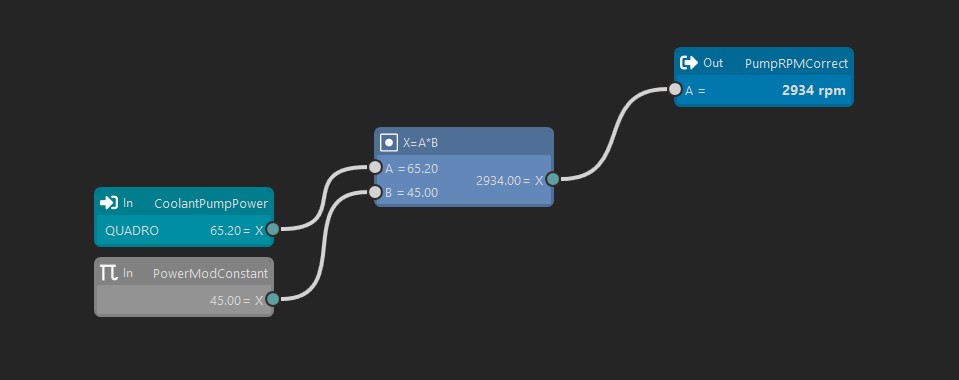

I have a similar issue. I don't know if mine is a faulty header, but I simply corrected it based on commanded power. Since this is a DC controller not PWN, commanded power can help set RPM as long as you know the max RPM. As you can see in the attached image my Alphacool D5 VPP is max 4500 RPM so I multiply commanded DC power percent by 45 and it gives me a linear RPM readout which should be relatively accurate.
»GWTechTalk« hat folgende Datei angehängt:
  • D5VPPRPM.jpg (25,92 kB - 89 mal heruntergeladen - zuletzt: Heute, 17:58)
