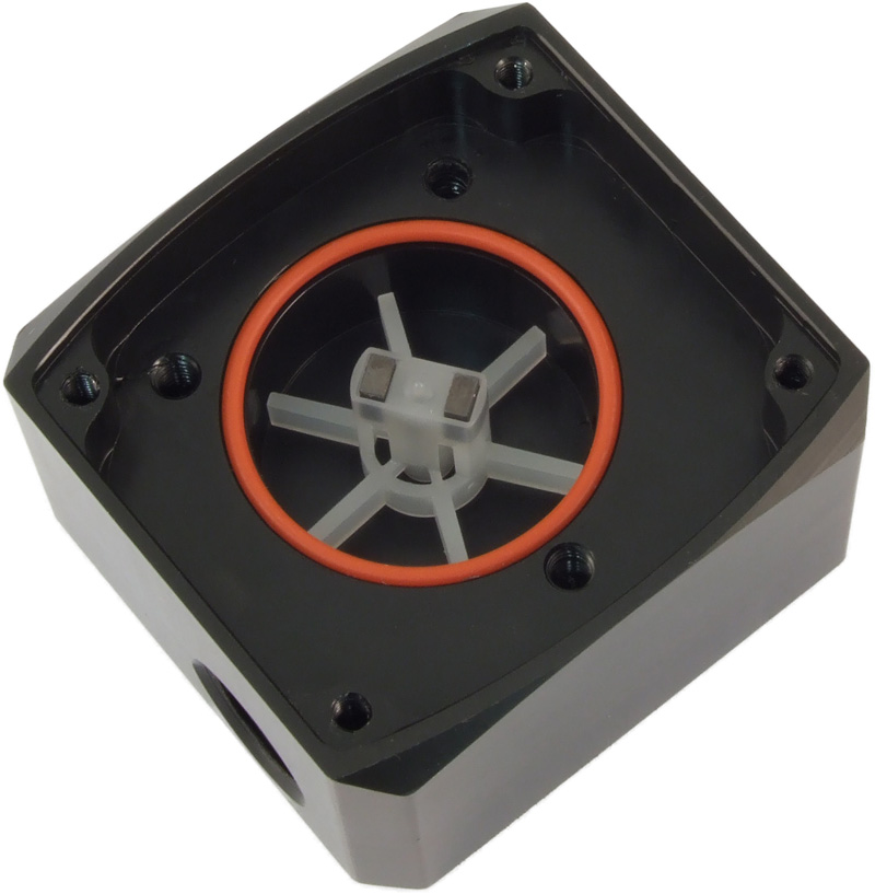

Hey Shoggy Pease tell me the above sensor multi directional since I have installed it with the writing upside down :) I really do not want to redo my loop....
Freitag, 7. August 2009, 19:25
So the sensor is upside down? That's not really recommend because the impeller will touch the top:
Pumpkin
Samstag, 8. August 2009, 09:30
no i mean i have it plumbed from right to left instead of left to right but the right way up
Samstag, 8. August 2009, 12:06
That doesn't matter at all because that sensor has no specific direction for the water.

On my aquasuite it says the calibration value in impulses/liter is 509 which make my flow around 82l/h which seems very low.
Donnerstag, 13. August 2009, 18:04
That sensor uses 169 impulses per liter.

I changed the calibration factore after reading this topic... until now I was a little bit disapointed with the value I read on my Aquaero for the flow sensor... with a Laing D5 pump I had a 80L/h flow on the controller.... but now after changing the calibration factor to 169 I get 225L/hour. Do you think it's normal with the D5 pump? I mean I just have to set ''169'' paramter in the flow sensor calibration and that's all? The result I'll get is realistic?
Thanks for your feed back,
Best regards,
Cyril
Montag, 30. November 2009, 10:37
I can't tell you if it is exact but this sounds MUCH more realistic :)
