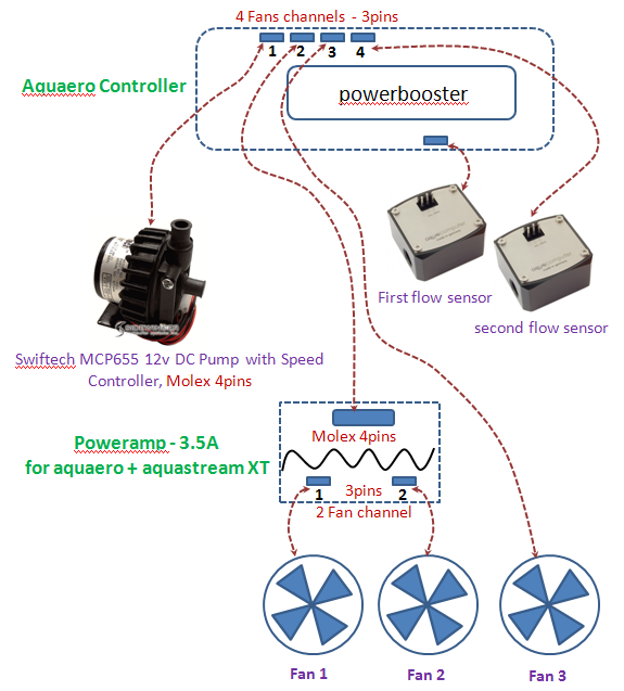

I have done a simple design, which I want to do .....
Can I do that ?!

That will not work. The poweramp must be connected directly to the PSU and the fan connectors are IN and OUT. You connect IN with one of the fan channels of the aquaero and at OUT whatever you want to power.
I also did not recognize that the MCP655 is the Laing D5 which in my opinion draws too much power. It might work for a while but I think by time it will damage the aquaero.
