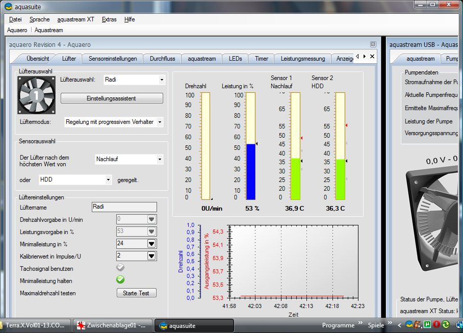

3) In case of using of 2 Adjust2 devices, how software will control them? Will it be one programm in which I will choose one device or another? Or maybe it'll be own programm for each adjust.
The Aquasuite is the Mainporgram. Every Device is shown in an extra flag. So you will have 4 flags - AE, two PAs and the Tubemeter
hm, i can't see this in demo or in manual, this is interesting
may explain more or better would be couple screenshots?
