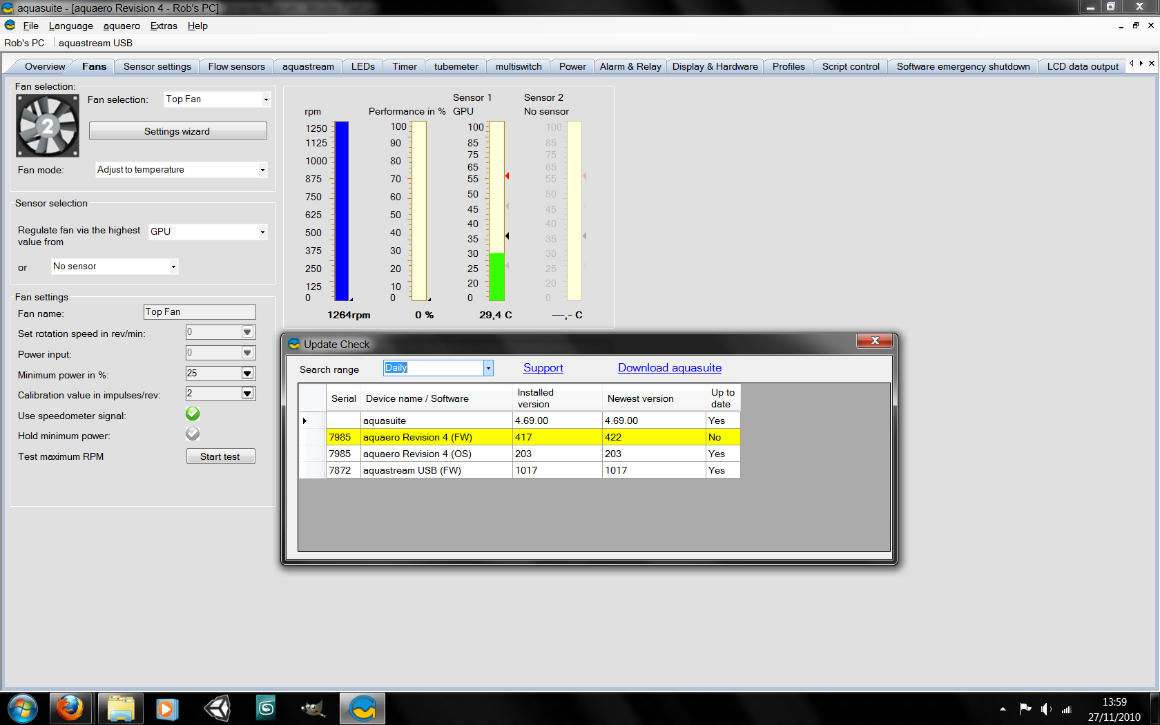

Hi everyone,
I been trying to update my firmware from 417 to 442 but cant find a place to download it from and now i really need an update as Fan 2 won't change speed and I'm hoping this will work, iv taken a screenshot to show whats happening also i would like to know how to flash the aquaero 4 as well.
»krypto« hat folgendes Bild angehängt:
Samstag, 27. November 2010, 22:14
You don't need to download it because it already comes with your aquasuite ;)
Click on aquaero in the menu bar and select the firmware update function.
