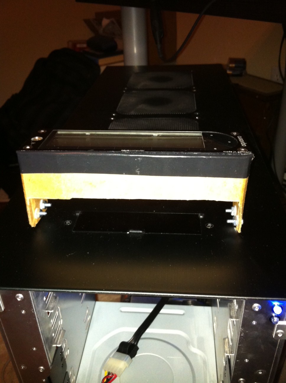

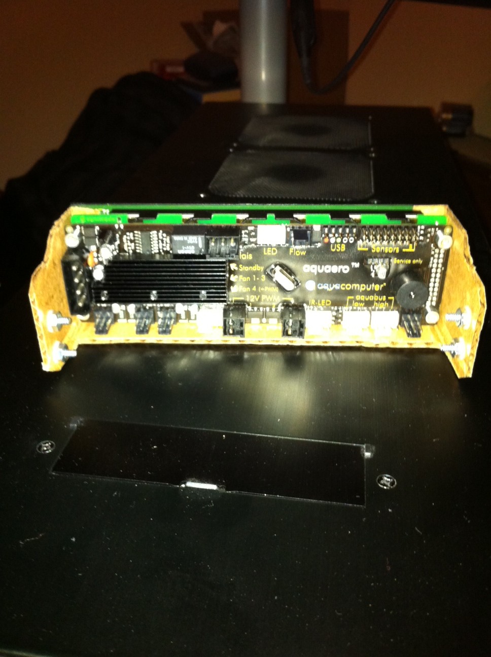

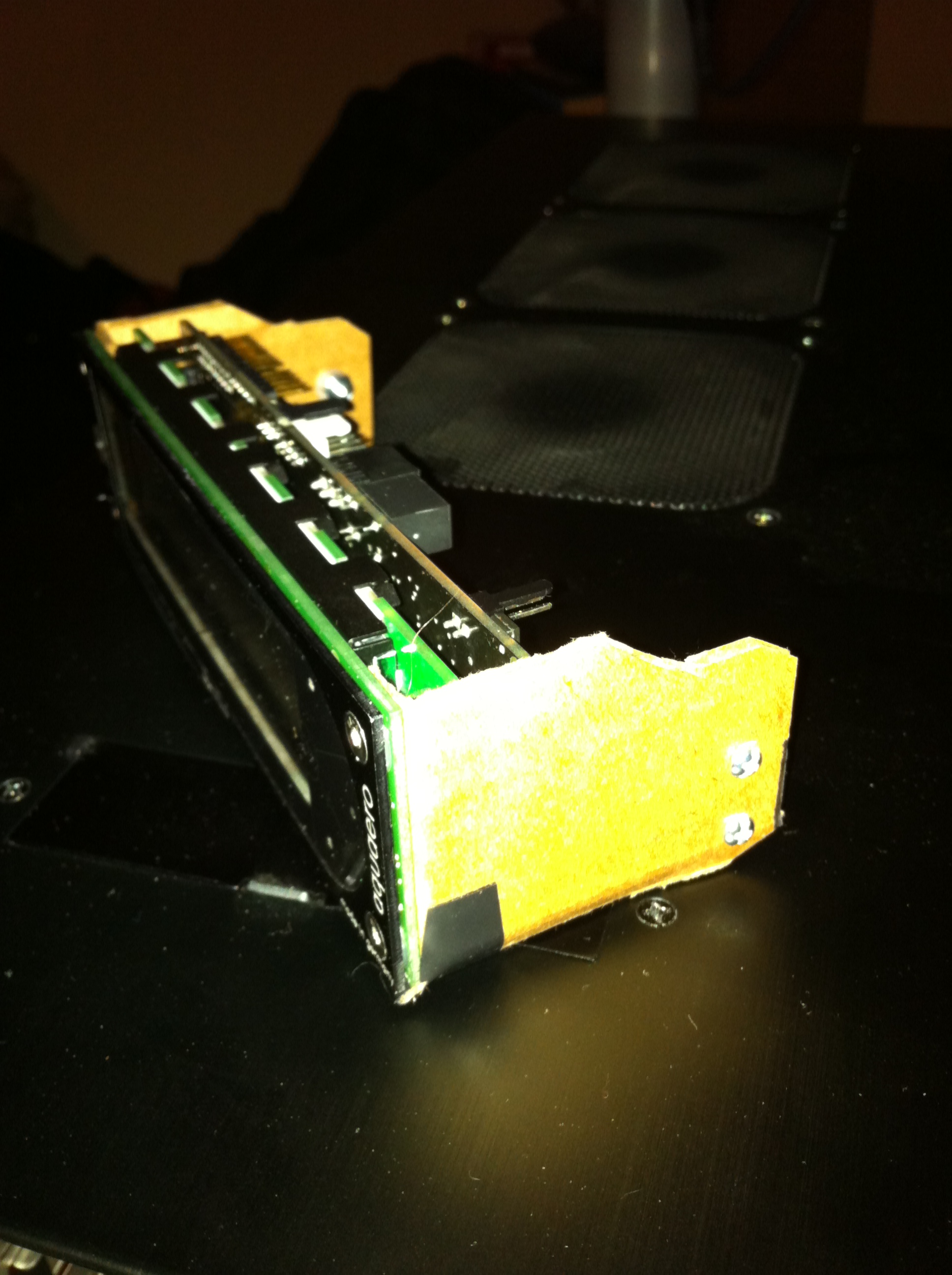

vtran73
Possible Fix for the Parasitic Capacitive Coupling problem
Freitag, 20. Mai 2011, 05:12
The method I used was based on theory that the unit needed better shielding from outside interference. I noticed that the unit functioned just fine outside the case it only exhibited the problem when mounted inside the case. To me the issue was not a grounding issue with the case. If the case didn't properly ground anything then all my components would not be functioning correctly.
Here is what I did in order to fix the false positives created by the XT screen and my reasoning behind everything I did:
1. I taped the mounting bracket with painter's tape on the side that will be contacting the case. Electrical tape seemed to amplify the problem. The reason behind this is I noticed that even slight contact with the case seemed to trigger the false positive so I tried to isolate the unit as if though it was outside the case. This allowed me to mount the unit into the case and I noticed no false positives. I let it sit for several hours to ensure no false positives occurred. So then I moved on to the next problem which was having false positives when the aluminum bezel of the case was mounted below the unit.
2. I removed the double sided tape on the plexiglass of the touch screen. I did this with the suggestions I found from PeeBee and others on the forum that seemed to help them. When I removed the double sided tape the keys where more functional. Meaning when I touched the area where the keys where suppose to be it actually worked better. Again I tested this outside the case. This may or mot not have any bearing to properly shielding the unit. I just noticed better functionality, possibly because the glass was better aligned with the PCB after the tape removal.
3. You need to shield the bottom of the unit. I tried paper, splicing electrical tape, and even cardboard and nothing worked. It appeared I needed something thicker. I went to the local hardware store and purchased rubber foam weatherseal tape. The foam tape was 3/4 inch wide, 5/16 inch thick. I adhered the foam tape directly under the unit making sure you cover the bottom edge of the PCB on which the glass is attached to. The reason why I chose the foam what that it was much thicker, made of rubber for insulation and most importantly it was could collapse thickness wise so that I could mount the bezel under the unit. I then mounted the bezel under the unit and noticed no false positives for several hours.
4. I readjusted all the key sensitivities to where they function at the bare minimum level. All your capacitive keys will still be functional which is the best part of this solution. I lowered the sensitivity to the bare minimum for precautionary reasons, since the capacitive screen and I were at war for several days I didn't want to give it any reason to fight back.
I hope this helps some of the users out there. I know went through hell over this unit. I just hope Aqua Computer will look at this solution and manufacturer a better shielding solution for the XT to block out all the external electrical interference.

vtran73
Fix Version 2
Sonntag, 22. Mai 2011, 10:57
I got frustrated with the occasional false signals that would go off with my previous solution even though it was still better then when I initially installed the XT without any modifications. The occasional false trigger signal would drive my crazy so I went back to the drawing board and so far for almost 24 hours I have not had any false signals. The solution I came up with was I made my own mount out of cardboard. Yes, I have tried just sticking the cardboard under the unit with the original metal mounts and I would still get false signals. Again if you read my previous posts, I based my theory on isolating the unit from EMI since it worked fine outside the case. I still don't believe it's a grounding issue (since it should get ground from the power supply) but more of a shielding issue and hopefully this will provide proof to the Aqua Computer engineers that maybe they need to better shield the XT unit from EMI. I have attached some photos of my cardboard mount:
Here is some videos that shows the XT mounted and working. In the first video show the Aquaero from boot up to me actually playing with the touch keys on factory settings and no sensitivity adjustments, no remote control needed here baby. In the past boot up and shutdown would cause false signals. The second video just shows the Aquaero going through the motions without any interference, in the past I could never even get it to go though one cycle without interference.:
http://www.youtube.com/watch?v=K9MA2VArNmw
http://www.youtube.com/watch?v=wto3tPPPh_E
Hopefully, this can help the Aqua Computer team fabricate a special mount for the XT that can better shield the unit from EMI. And hopefully, they can send it to us with problems and make us all happy. :)
