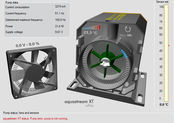

I’m having some trouble getting my aquatream XT USB (Ultra) up and running. The led stays red on the back of the pump, I have tried a hard reset as described the manual at 9.1. I have connect the pump by USB that results in the following information.
Here it says that the pump is getting 9.61V but it’s still not running, a tried measuring the voltage on the controller itself at the red circles.

The points that you are meassuring are already the "modified" power for the pump. It is normally AC with around 9V.
Well, a permanent red status LED at the back means that there is a serious problem with the controller. It is very likely that something is damaged and needs repair. The fact that there is no power output to the pump already indicates that there is a major problem because normally the pumps always runs - no matter which weird settings you are using.
