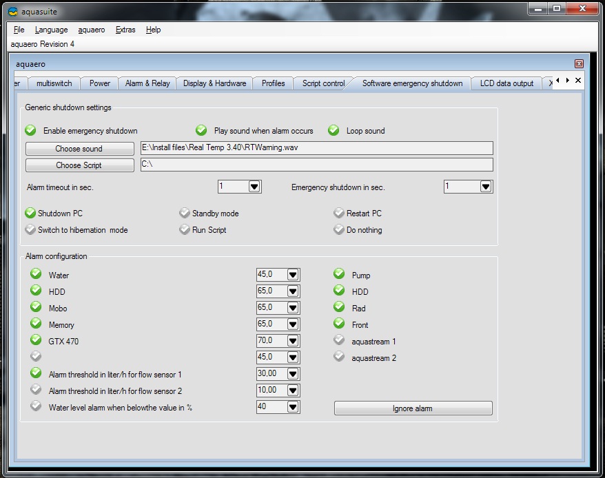

Last thing was to set up the software shutdown options: i set some temp alarms and fan failure alarms==> problem was back in full force, it almost systematically occurred.
One thing i noticed was that in the software shutdown tab I did not activated alarm for Fan 4 but it seemed to automatically get activated.
This was a problem in itself because i do not have a fan on this header so it activated software shutdown; i clicked the radiobutton fan 4 off several times but when i rebooted it got reactivated every time.
When i turned the software shutdown option off the aquaero works perfect again.
The only thing i still have to try is to connect a fan to header 4 and test the software emergency shutdown option again.

I connected a fan to the 4th header and activated the software shutdown options.
Everything still runs smoothly; so it is because i didnt have fan connected to this header i got this strange boot issue, i dont know but is seems this way.
Another thing i noticed and i want to know if anyone has the same behaviour:
When I deactivate fan4(front) in software emergency shutdown tab, on reopening the soft it is reactivated by itself.
When I deactivate fan1(pump) in software emergency shutdown tab, on reopening the soft has also deactivated fan 4 by itself.
I mean this is not normal behaviour is it?
Is anyone having the same issue?
