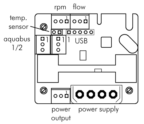

I've seen a Poweradjust 2 diagram showing where a temperture sensor hooks up. I've seen a Poweadjust 2 diagram showing where two Aquabus connections are. I've looked on the web for an hour and not found an English Manual for the Poweradjust 2, or a review, or anything that shows what all the connectors are for on the Poweradjust 2. Can someone please provide a link to an English manual for the Poweradjust 2? If there is no manual, can someone provide a diagram detailing what all the connections are for on the Poweradjust 2 Ultra?

RPM header is only for reporting? If I hook up a pump to PA2Ultra cand I also add a fan to it?
bcikota
Samstag, 28. Januar 2012, 17:31
Hi TheSmoker,
PA2 only has one output channel, so you can hookup several things to that output, but they will all have the same control value (for example several fans).
Kind regards,
Boris.

Hi Psychor,
Using the cables provided with PA2 (the ones that look like a fan cable, 3 pin connectors) you connect it something like this:
AQ5Pro HighSpeed Aquabus connector -> PA2 Aquabus connector 1 / PA2 Aquabus connector 2 -> PA2 Aquabus connector 1 .... and so on.
Hope this helps.

I have another quesion regarding wiring. I have 2 Swiftech MPC355 that I will be using with my PowerAdjust 2's. I am going to be making my own cables, and was wondering how to connect them. I know the blue wire is a Tach Sensor, so which is the best way to connect it to the PA2? I have included a diagram with the 2 options that I think would work, but need some further clarification before I start splicing wires. :D Any help will be greatly appreciated.
bcikota
Freitag, 20. Juli 2012, 01:26
Hi Mr_Armageddon,
Use option 1 for connecting your pump to the Poweradjust. The connector marked RPM is actually an output signal. It can be connected to the motherboard so the system is shutdown on loss of signal for example.
Kind regards,
Boris.

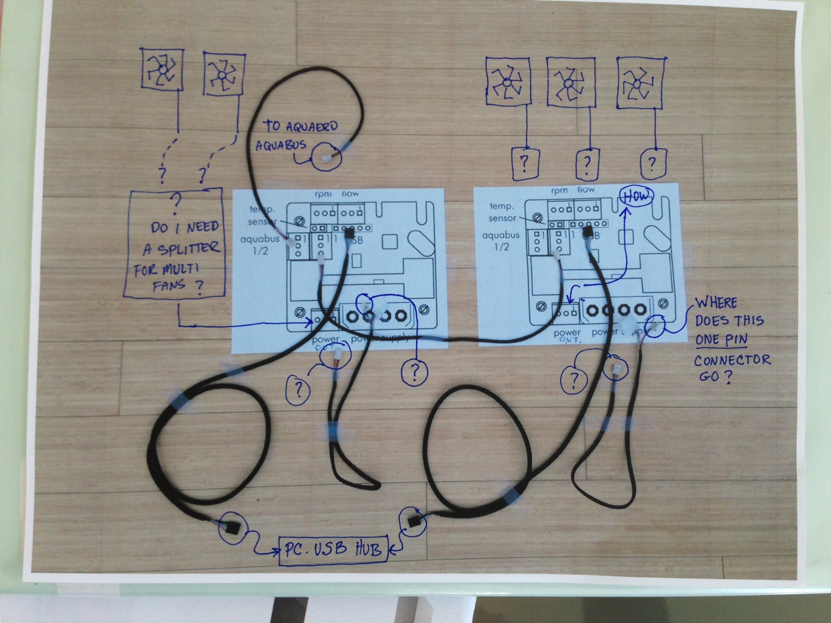

marchitect
Poweradjust setup Help needed
Samstag, 9. März 2013, 20:19
This thread is a good start but I'm still looking for some more clarification on how to set up the poweradjust units.
I've included a diagram of what I understand so far but still need some guidance.
Where do the single pin male connectors go?
Where does the 3 pin female cable, at end of Molex, go?
Do I need to buy special fan splitter cables to connect multiple fans to one poweradjust?
Do I need PWM fan splitter cables?
Thanks so much.
»marchitect« hat folgendes Bild angehängt:
oldcompgeek
RE: Poweradjust setup Help needed
Montag, 8. April 2013, 08:14
Thanks so much.
I am in the same boat as you are (or were) lol. This poweradjust 2 unit doesn't explain things very well, and I just simply plugged my pump into the 3-pin power slot, and ran a 3-pin patch cable from the rpm header to the motherboard 3-pin header to shut down the system in a "no value" or "no rpm" situation, like another poster had written to do. I will connect my flow meter to the "flow" header too, but have no idea what the single-wire that branches off the 4-pin molex is for either...??? I have read that you can connect 3 matching fans to the 3-pin power slot via "y" cable and they'll register the rpm's and run fine...I have read that on here a few times actually!! If you figure it out, plz let me know if ya don't mind... In my situation, I'm lucky as I have a decent Zalman fan controller with 6 channels, and the last 2 are toggles as well. I also have a Sunbeamtech multi panel that has two fan control channels as well that my kids got me for xmas too so I'm covered on the fan control issue... oh and my Elysium case came with 2 of the fan control pcb's that give me like 6 spots each so...lol covered. Do you run an aquero too? or using the "aquabus" headers? I wasn't sure if they could be used for anything else or not?
