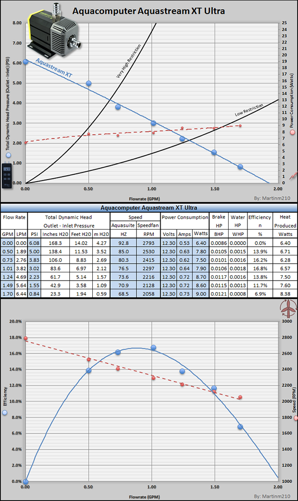

The Aquastream XT doesn't have the ability to read flow without a external flowmeter installed, so unless you have attached one its a false warning.
At which speed/Hz is your pump running? According to this chart you approximately will get 1GPM+ with a loop like yours (2.5-3PSI) and the pump running at max (+-75Hz) That is more than sufficient :) With modern blocks/equipment you can have flow as low as 0.3-4GPM and still get good performance, eventhough 1GPM is recommended.
