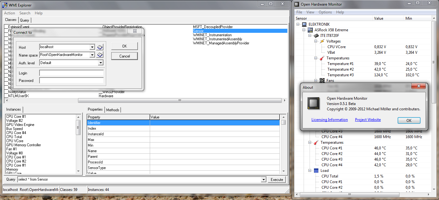

BorisTheSpider
Freitag, 21. September 2012, 01:56
Thanks Sebastian.
I tried with WMI explorer. With 0.51 I get no instances in the sensors class, but they show up ok with 0.40
No idea why, but it doesn't matter since it works with 0.40
