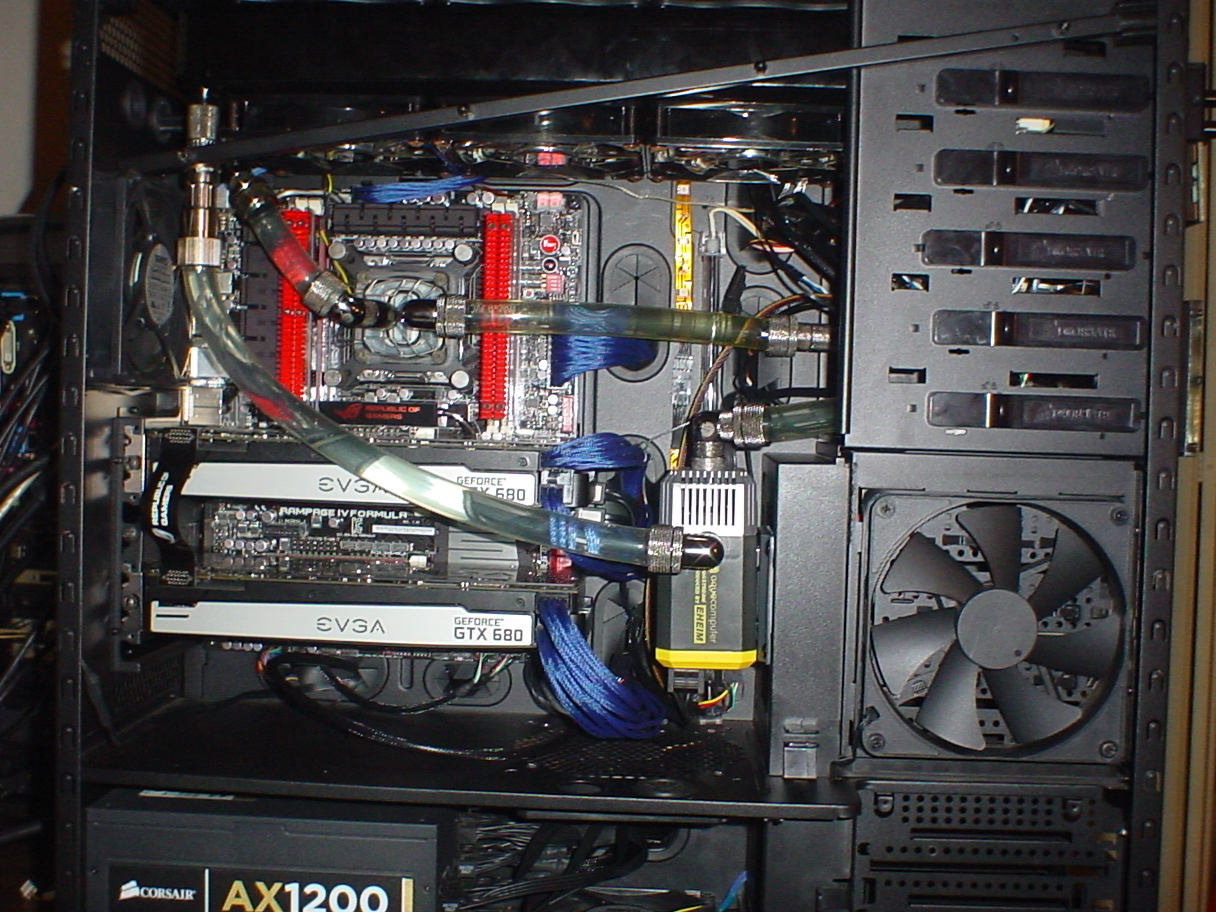

i dont know about the reverse flow but i can show u how i have my pump and seems to work fine for me dont know if its bad to have it this way or not.
»pegleg« hat folgendes Bild angehängt:

Hi pegleg,
It's good to see that I'm not the only one who is thinking of mounting the pump like that. Maybe you also have the feeling that the pump's inlet and outlet should have been reversed to begin with. It would make a lot more sense in terms of mounting with the flow reversed (well, at least it does for me). ;)
Judging from you picture, your pump is mounted/bolted directly to the chassis there. Does it generate a lot vibration noise like that ?

Samstag, 27. Oktober 2012, 23:49
when it set at 76 hz but i took it apart because of my flow meter ,i took some velcro and stuck it on there only one side not the otherside of the velcro and that stoped the vibration.the pump was not loud just would vibrate threw the metal case.velcro was all i had at the time.now it is very quiet.

Sonntag, 28. Oktober 2012, 11:42
i dont really use the velcro to hold it just for the vibration,i have it bolted to the plastic piece there.
