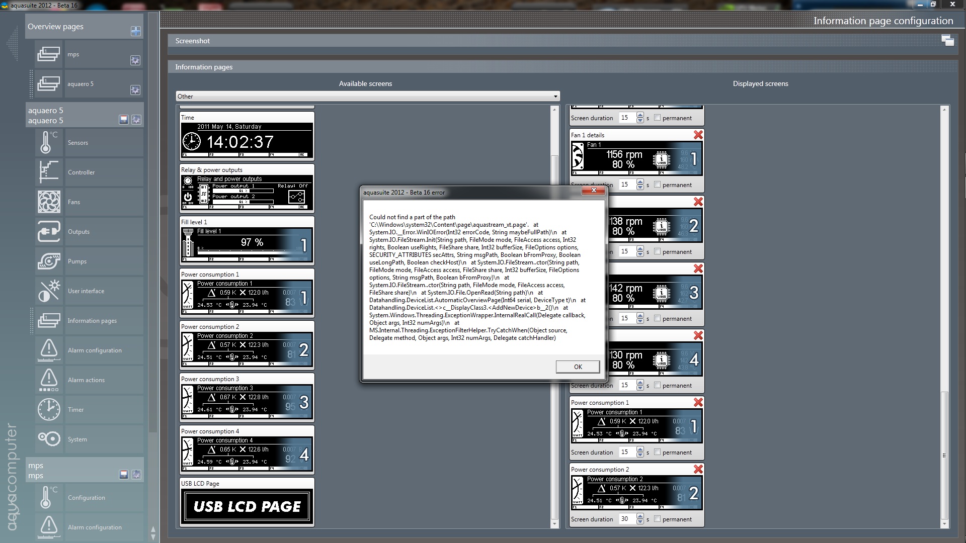

no i clipped the 5 pin and hooked that to my flow sensor. i'm using the 3 pin from pump to a y 4pin then to the aq5 and on the other y4pin is my flow sensor. when i hooked this up for the first time my pump i could control on the aq5. i dont know what i did or what happened it just comes up on screen with nothing.when i hooked the pump backup to the computer i got this. could this be the reason why it wont show up on the aq5 xt screen. wish someone could tell me how to get my water flow up into the chart 1 on the screen i did it ones but cant for the life of me do it again .is there something that can explain how u take like your relay and power outputs how do u put stuff on that so there will be a reading on it. and also on the power consumption 1 i did get that up there i used my flow and 2 temps reading but i hate to play this guessing game on how to put stuff up there and hope i dont destroy something in doing this. well thanks again

I am not sure how you have connected everything. Maybe you can provide a photo?
