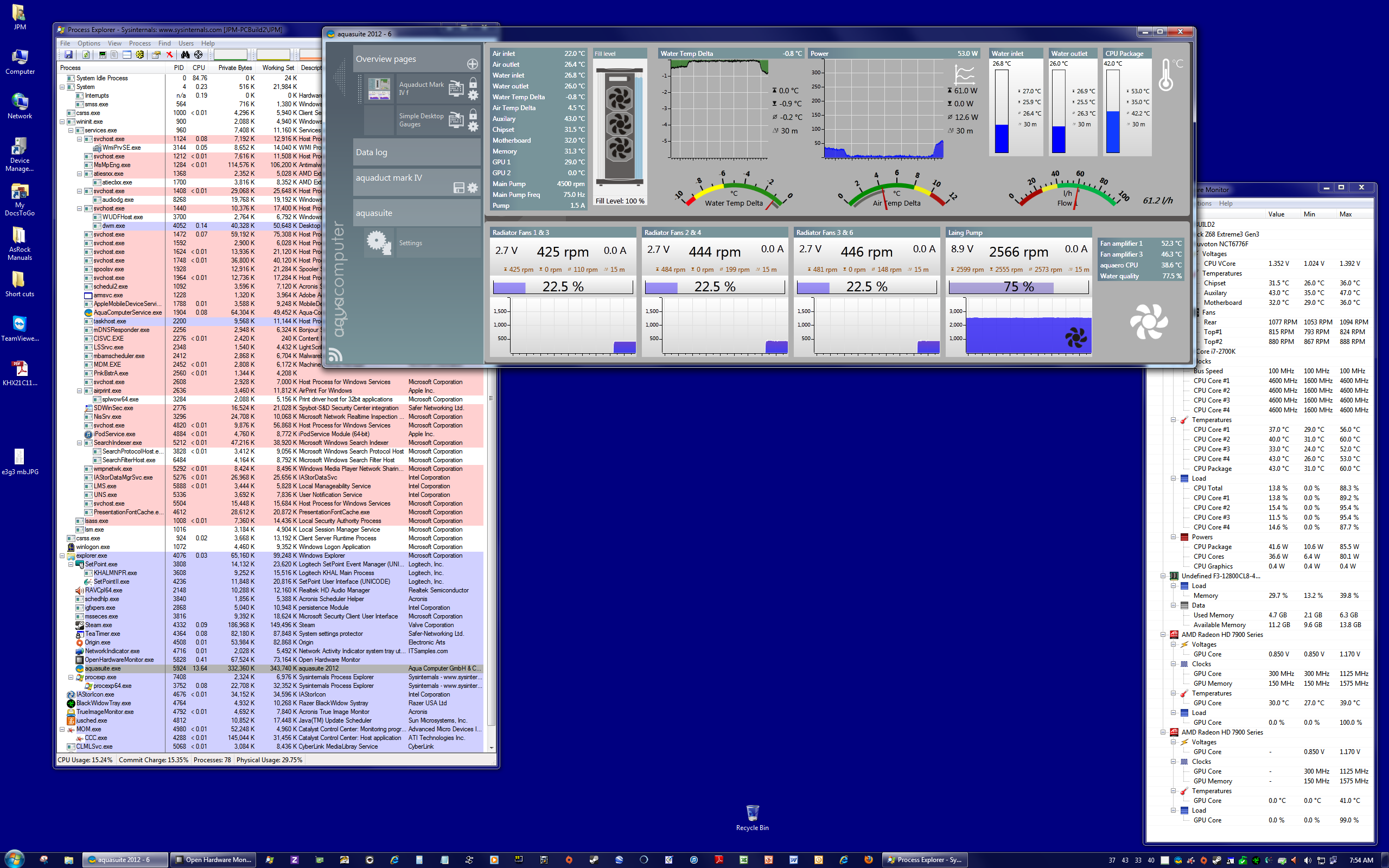

I thought this memory leak might have been addressed in -6, but it was not. Dissapointing. Here's a few screenshots with up to 1.3MB of private bytes... i did not do anything special to get to 1.3 (in AS-4), just let it sit Minimized in a page view.
If i just leave it sitting minimized without any page active, it wil not build a memory pile after days, so it's something with the 1 hour data and plain old good housekeeping practices in the code.
»jpmboy« hat folgende Bilder angehängt:

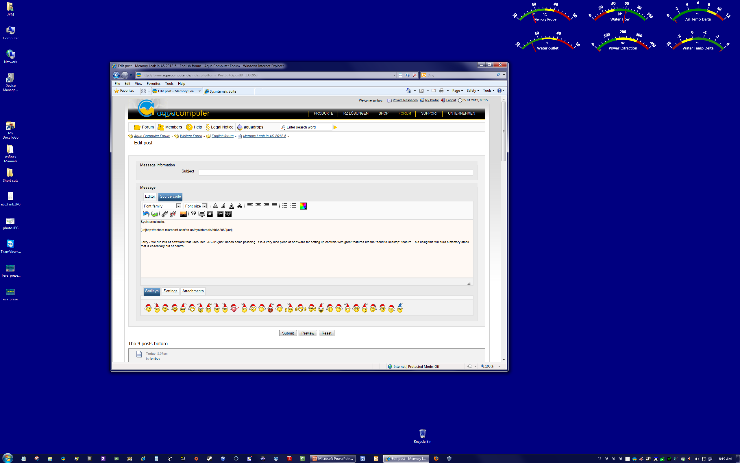

Sysinternal suite:
http://technet.microsoft.com/en-us/sysinternals/bb842062
Larry - we run lots of software that uses .net. AS2012just needs some polishing. It is a very nice piece of software for setting up controls with great features like the "send to Desktop" feature... but using this will build a memory stack that is essentially out of control.
»jpmboy« hat folgendes Bild angehängt:
