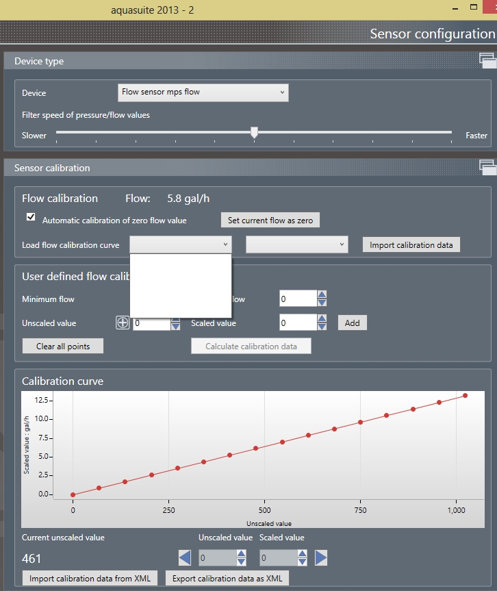

So I reset my MPS 400 today and now the drop down menus for "Load flow calibration curve" are completely empty. Any idea what's going on?
As a result my flow is showing ~6 gal/h which is incorrect. Prior to resetting my MPS 400 it was 80+ gal/h.
»Psychor« hat folgendes Bild angehängt:
