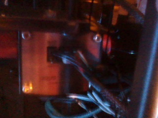

pegleg
Sonntag, 22. September 2013, 05:04
when i plug my aquastream xt pump in when i first start computer it will say found new hardware but when the flow sensor plug in all by itself it will not say this so can the flow sensor be bad?
»pegleg« hat folgendes Bild angehängt:
