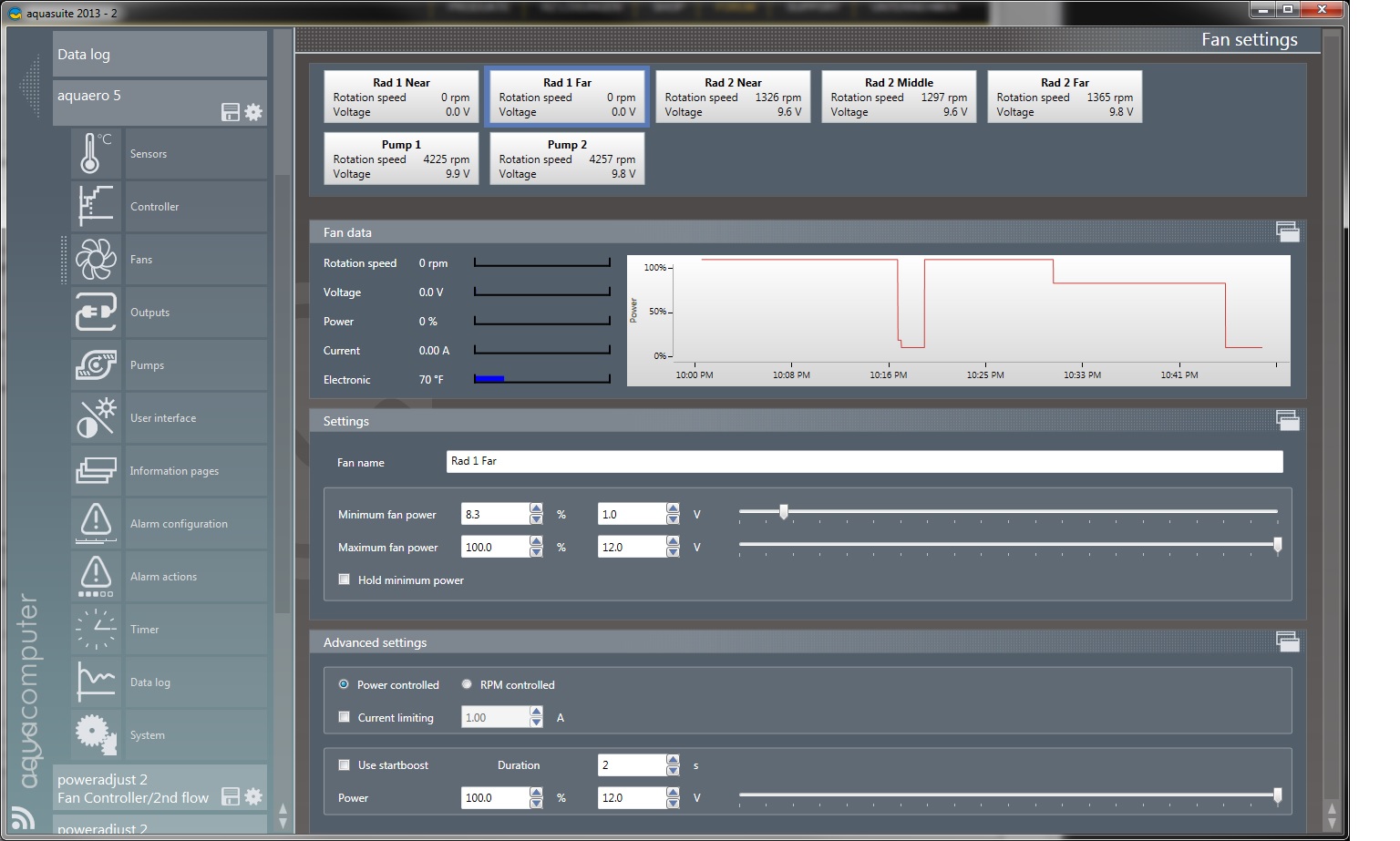

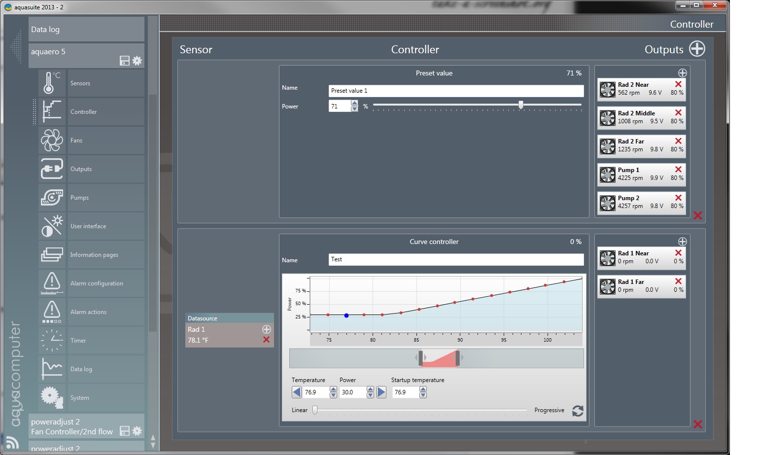

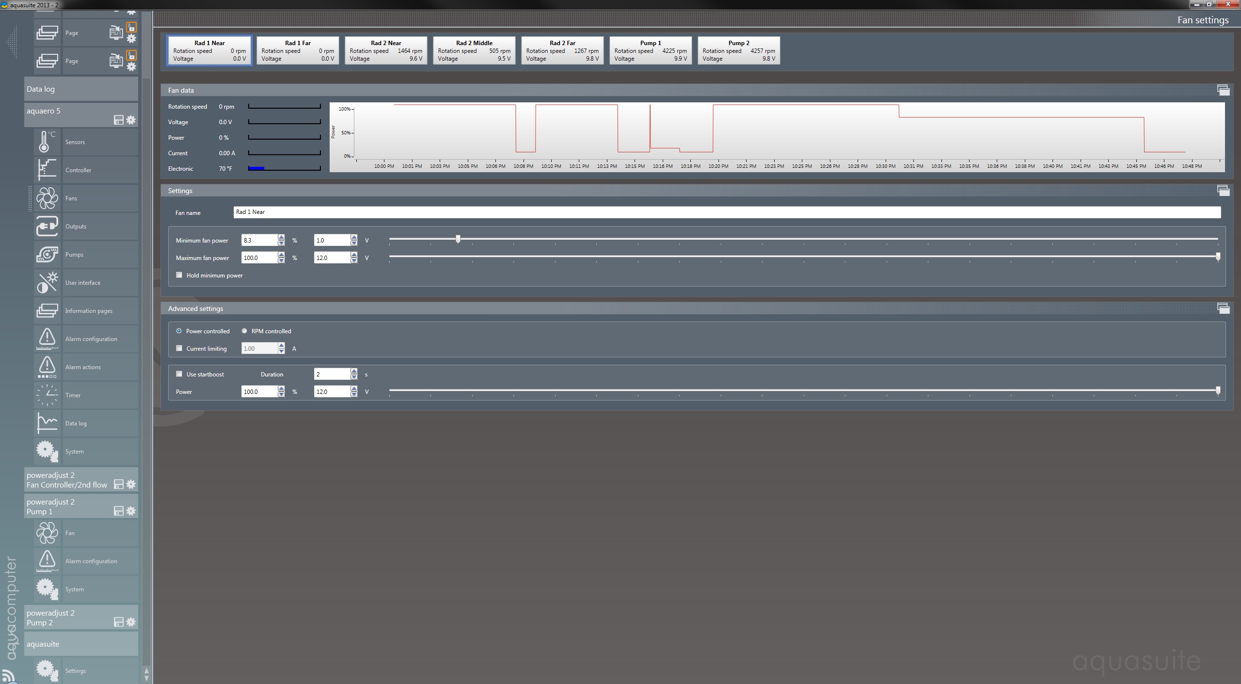

I uploaded 3 photos, first of the controller setup, and then of each of those fan banks (2 per Fan in a push/pull). I've been trying to set the minimum of the fans to 30% at a base line temp, around 76 degrees F, and then let the curve go up the hotter it got. I've messed with the fan power at below what the current output of the radiator was just to see if the fans would jump to life, which they did not.
Hope this helps you, and im happy to provide more info.
Again, thanks for the help
Kobgar

Donnerstag, 24. Oktober 2013, 08:31
In the current version the curve controller cannot use °F as unit. The setup is in °C.
In the next version the curve controller con handle different units.
