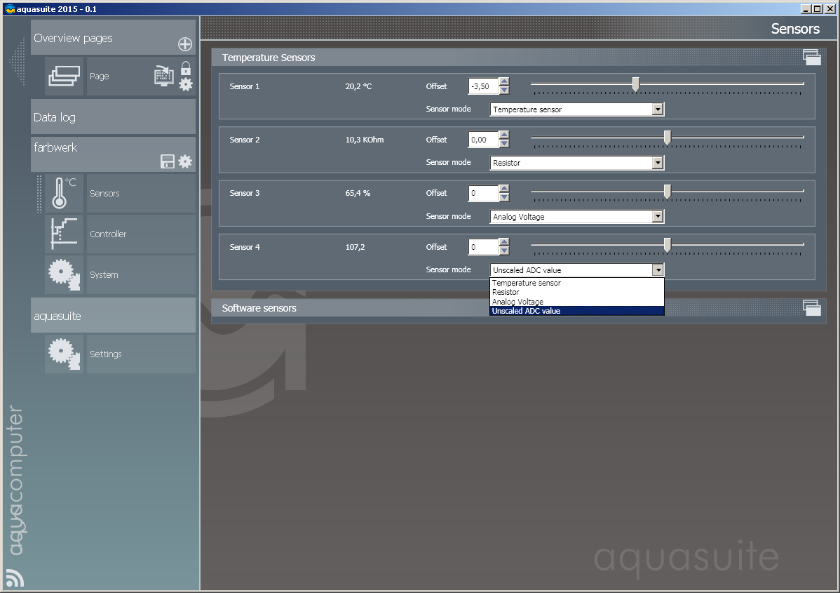

Four analog sensor ports allow a direct control by temperature (-40 °C to +100 °C), voltage (0 to 3.3V) or resistance (100 Ohm to 25kOhm).

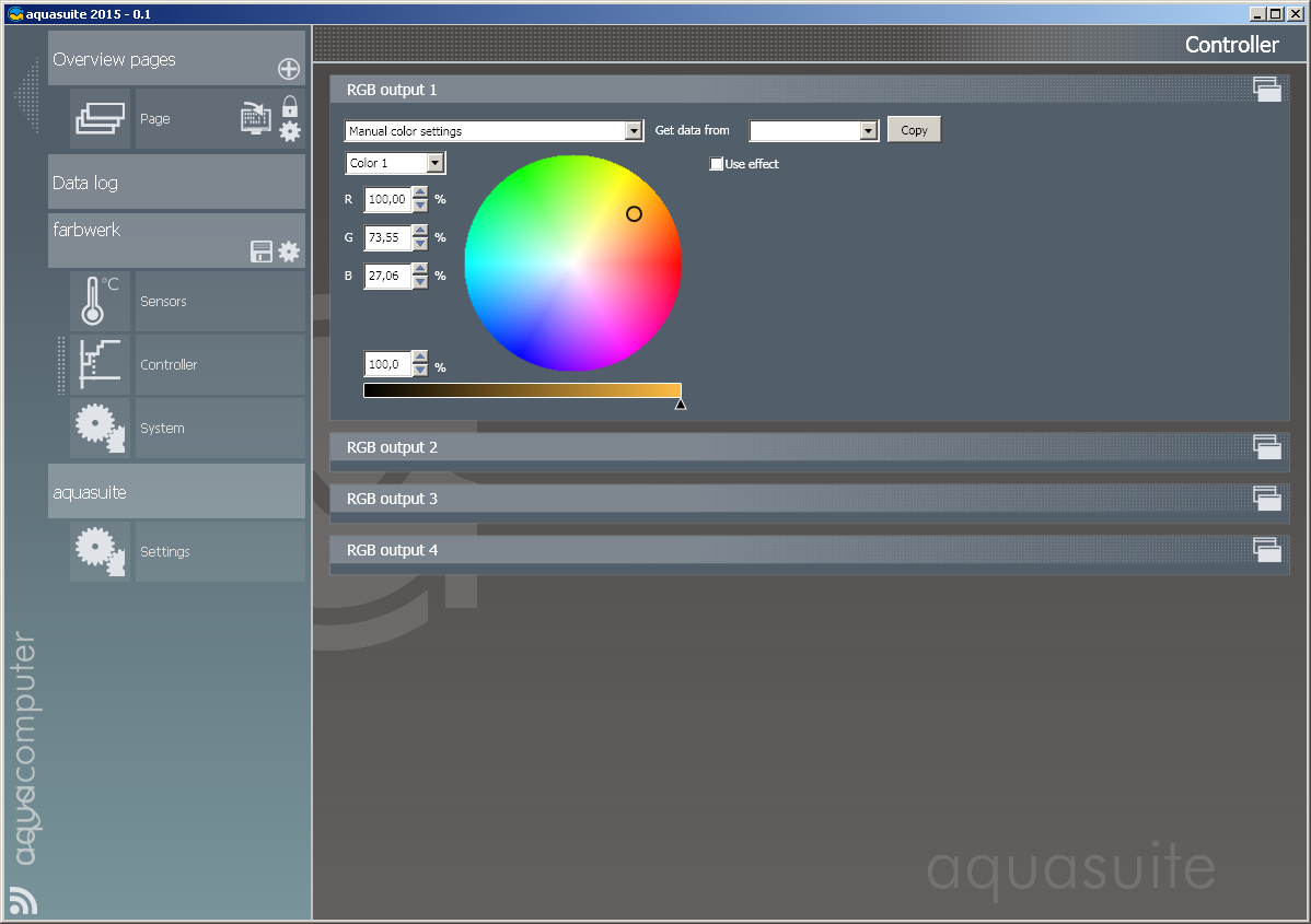

1.) Direct color selection
Intuitive interface controls of the aquasuite allow a precise selection of the color and adjustments for the intensity and brightness.

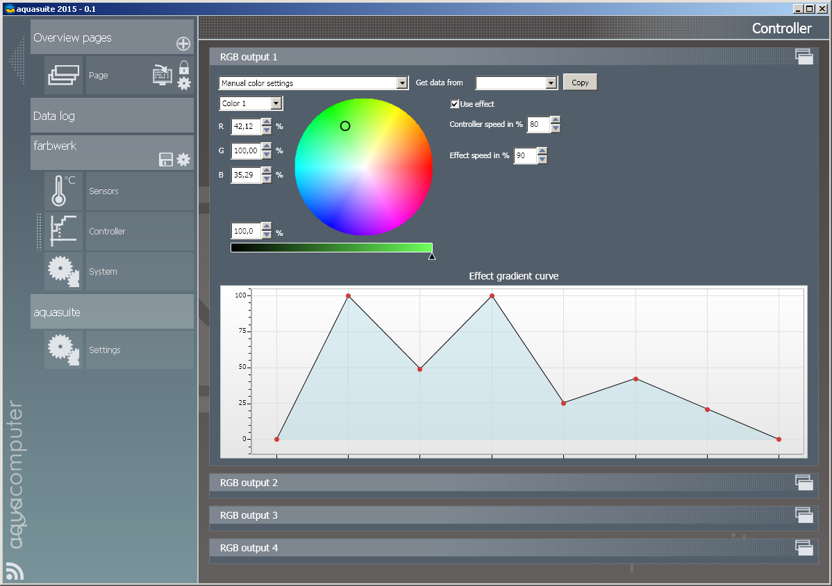

3.) Effects
A brightness curve can be defined to add a pulsating effect.

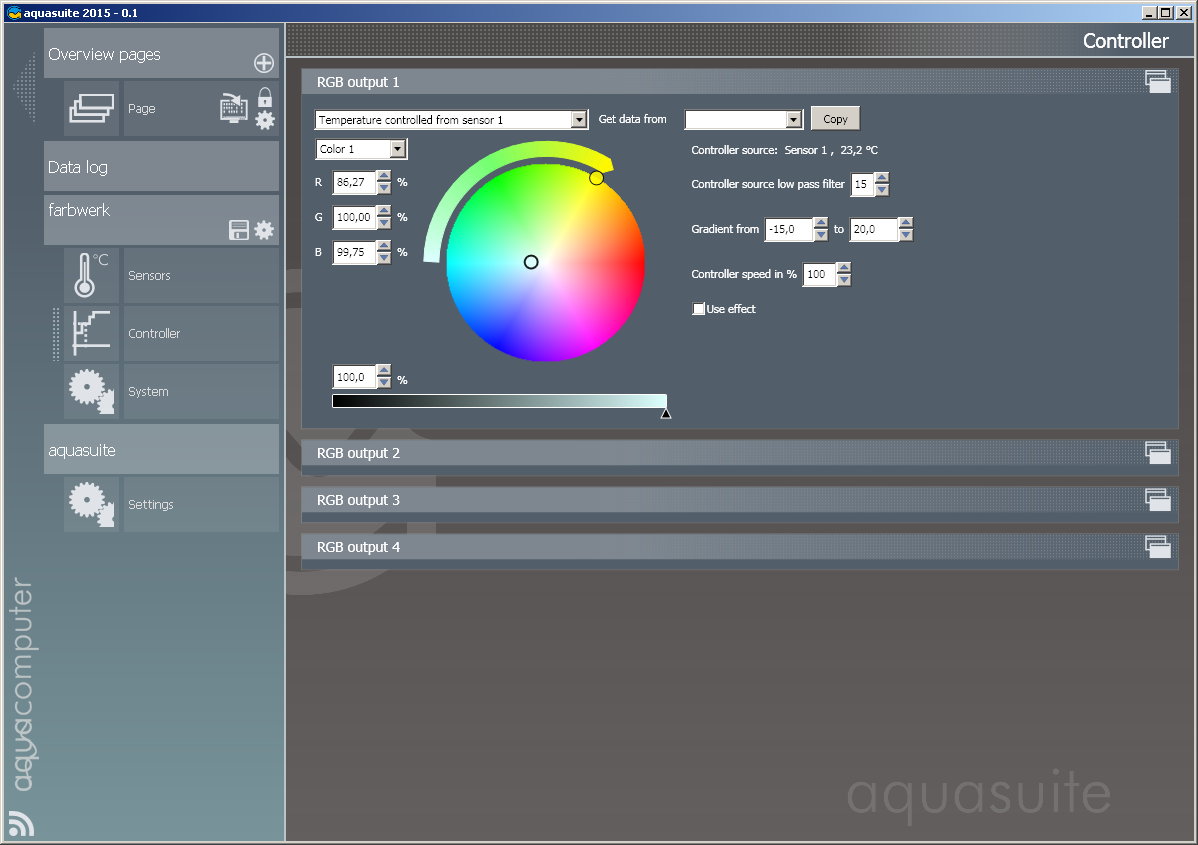

4.) Control by sensor inputs of the farbwerk
The sensor inputs of the farbwerk can be used to change the color of the assigned channel directly. For example a color transition between 20 °C and 35 °C can be set in the aquasuite and will be processed by the hardware of the farbwerk. In this case, an USB connection is only necessary for setup and can be disconnected once the configuration is saved in the farbwerk.

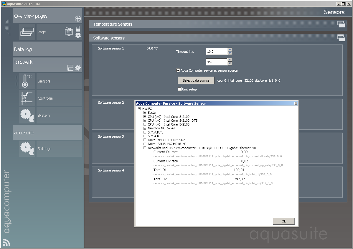

6.) Software sensors (e. g. CPU load, network etc.)
Like the aquaero, the farbwerk can be configured to use software sensors. The communication between the aquasuite and the tools HWiNFO, AIDA and Open Hardware Monitor allows to use many different system values to control the channels. For example, the CPU load can be used to automatically adjust the color within a specific range. Since these software sensors can be also accessed via Bluetooth, it would be possible to display them on a smartphone.
