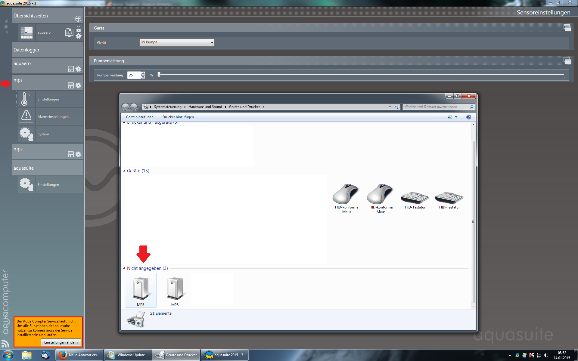

Mittwoch, 14. Januar 2015, 08:56
USB and molex a enough. It should-be as MPS in the Aquasuite and Windows devices.
Check and double check the USB connected.
Dieser Beitrag wurde bereits 1 mal editiert, zuletzt von »EnigmaG« (14. Januar 2015, 09:02)

EnigmaG, I'll check that once I get home from work. Is there anything special that needs to be done to install that USB device? Or should it just be auto detected by Windows?
Mittwoch, 14. Januar 2015, 18:54
Auto detected.

Mittwoch, 14. Januar 2015, 23:01
Thanks for your help guys, I've got it working. The device was showing up in the control panel as unknown. It appears to be crucial to install the Aquasuite software prior to connecting the USB, something I did not do.
Steps to follow if you have the same problem:
  1. Connect pump only through power supply molex
  2. Boot PC and uninstall Aquasuite and all unknown USB devices (Through Computer Managment - Device Manager)
  3. Reboot
  4. Install Aquasuite (I set to run as administrator and start on boot)
  5. Complete Shutdown and Power Off (PSU Switch Off)
  6. Connect USB to Pump and Motherboard
  7. Boot Windows normally and the device should successfully be detected as MPS and available in Aquasuite.
