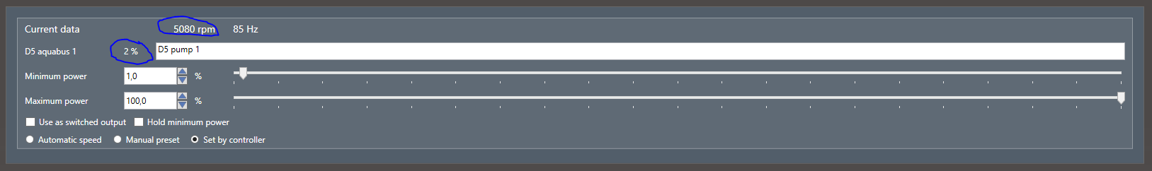

So I picked up my new AquaComputer D5 pump with build-in AquaBus and USB support today, and I hooked it up to the "Aquabus High" connector on my Aquaero 5 LT. The pump appears in the pump section in aquasuite, I then set the pump speed to "Set by controller" and added it to a controller based on the CPU temp. When I go to the pumps section in aquasuite, it says that the pump is running at 1-5%, but at 5000+ rpm, which is what it should run at at 100% (pic below). So does anyone have an idea of what I configured wrong in AquaSuite? This pump is obviously supposed to be adjustable, and I want it to run at about 1000-1800rpm at idle.
Thank You in advance! :D

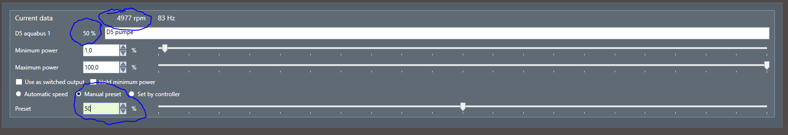

Try to run the pump in the manual mode. Can you change the pump speed?

I set it to manual, and tried 10%, 30%, 50% and 80% power, but it keeps on running at like 5000rpm. Pic below at 50%.

hooked it to the usb and Look for a new firmware.

finally got it working! Had to connect it with USB and then change the priority from USB to AquaBus. Thank you very much for very fast response
