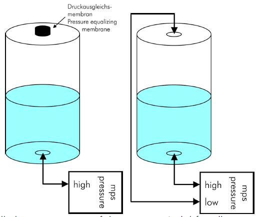

I presume that sensor high port (as intake) needs to be connected to the bottom of reservoir and low port as (outtake) to water pump?
2.If I use that sensor as the reservoir fill level sensor so do I have to use

Either way you have a high flow sensor to measure the flow rate or you have a mps pressure sensor to measure the pressure or a fill level.
The high flow sensor uses G1/4 threads of course while the mps pressure sensor has the small M5 threads because of its compact size. This also does not matter because no water flows through this sensor. It only measures how strong the water pushes against a membrane inside the sensor.
You should take a look at page 7 and 8 of the manual to understand how it works and must be set up.

Yes, the reservoir cap must have one port available for the pressure sensor.
Simple physics says that as the water temperature increases, the air in the reservoir top heats and expands increasing the pressure. If this is not compensated for, the pressure applied by the air will make the water column appear taller than it is, and the sensor will provide incorrect level readings.
You can either use the Equalization Membrane and leave the Low port connection on the sensor open, and both will reflect the local atmospheric pressure.
Or you can connect the Low port of the MPS 40 sensor to the reservoir top by tubing.
There are various multi-port caps with 2 or 3 ports available for your reservoir.
