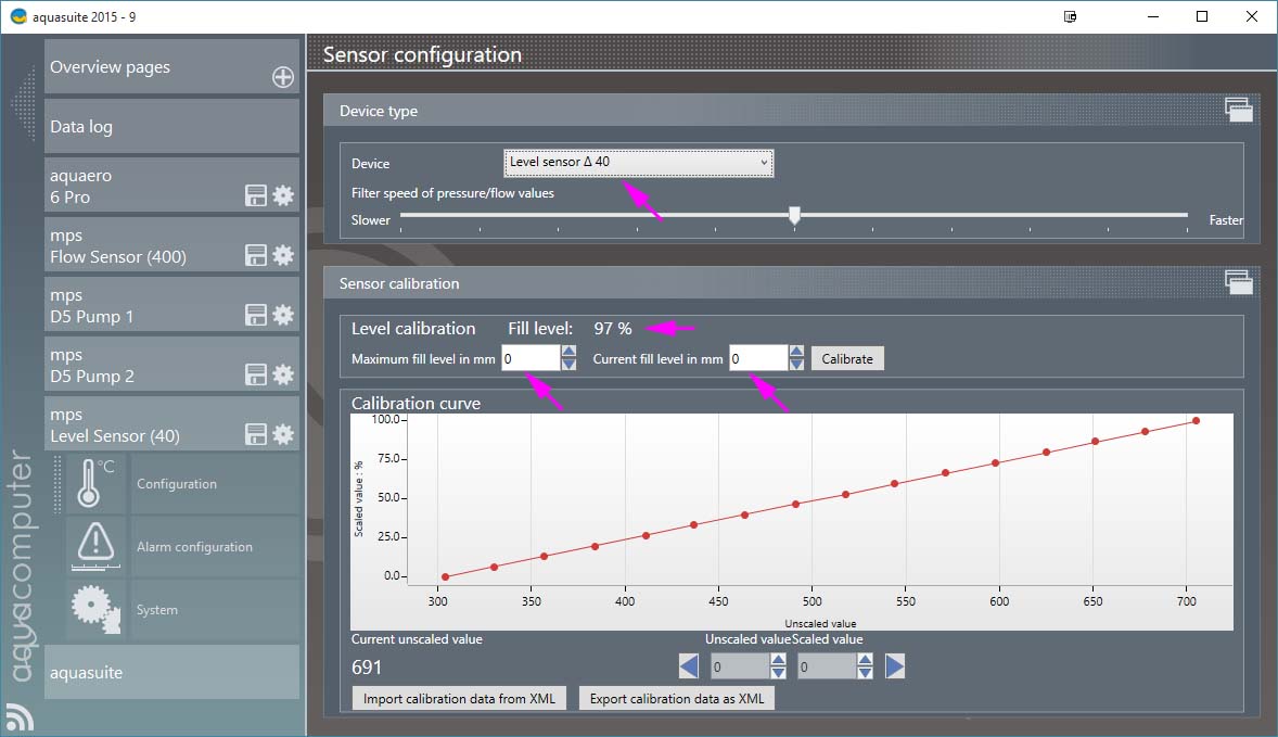

Fill Level Sensor:
The MPS Manual covers installation of the fill level sensor in section "6.3. Installation as a fill level sensor", and calibration in section "12.3. Sensor configuration fill level sensor".
You need the Fill level sensor connected by USB, and then it is four steps (do not adjust the calibration curve):
1) set the device type (Level sensor Δ 500)
2) enter the Maximum fill level in mm (this is the reservoir height from bottom to top)
3) enter the Current fill level in mm (This is from the bottom of the reservoir to the coolant level, without foam)
4) click "calibrate"
The coolant level in the reservoir will read as a percentage.
[attach]5495[/attach]
You can install the Pressure equalization Membrane when assembling the reservoir and it does not need attention after that.
The membrane simply allows air to pass through, keeping the top of the reservoir at local atmosphere pressure, which is then the same as the Low port of the sensor.

The result of that "calibration" isn't even close to the real values! It works for the level you have, but the rest is a wild guess that depends on the size of the tank, the hight above the sensor and probably a thng or two I haven't even thought about.
I found that you can do it quiteceasily if you depressurize the system between each meassurement.
1. Let the pumps run and fill to the desired level.
2. Remove the power cable.
3. Equalize the pressure. You have to open the highest point of your loop as well as the top of the tank.
4. Wait for the raw value to stabilize (a couple.of minutes).
5. Close all open points.
6. Connect the cable.
7. Wait for the raw value to stabilize (as long as needed, I waited 10 minutes, but I think 5 is enough).
Repeat at intervals, the more the better. I did it at every 50mm from 50mm to 350mm. The result will show you a completely different result than the auto-calibration!
